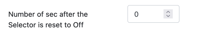

Just had a quick look, and from my understand the Konke cannot switch Off by itself.
But can you check the settings and especially "Number of sec after the Selector is reset to Off" ?
In case you have a value above 0 , this is reprents the number of seconds before putting the selector in an Off position

pipiche wrote: Friday 14 January 2022 12:03 Just had a quick look, and from my understand the Konke cannot switch Off by itself.
"Number of sec after the Selector is reset to Off" was (and still is) set to 0
Cheers, Jan
