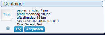

Using garbagecalender Dummy text device in Domoticz.
In text device show three text rows with the next three delivery days. (Updating from garbage calendar website lua script)
In dashticz these three lines show up as 1 line. Is there a way to show each day on different row, as in text device Domoticz.

Can you post your setup.
Normal you can us html commands to Dashticz for layout, like <br>

Dashticz garbagecalendar doesn't support Gemeente Montferland so I use https://github.com/jvanderzande/GarbageCalendar
In Dashticz I added block Domoticz. In custom.css I can style text: allign, height, color .. and so on
I think the way Dash0ticz import data from Domoticz device is the issue

madpatrick wrote: Thursday 06 January 2022 10:26 Can you post your setup.
Thanks for the hint
I found the solution
/*afvalcalendar*/
.block_1108 {
height: 120px !important;
font-size: 12px;
content: "\a";
white-space: pre;
color: white;
gvandick
Posts: 39
Joined: Saturday 01 July 2017 12:48
Re: Dashticz TEXT device
Post by gvandick »
Schermafbeelding 2022-01-09 105947.png (5.9 KiB) Viewed 3616 times
