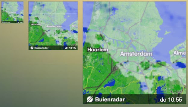

A new Dashticz release with the following functionality:
* Scaling of frame content Use the new block parameters 'scale2fit' and 'aspectratio' to define the scaling and height adjustment.
* Dials now also support blinds See release notes and documentation via:
https://dashticz.readthedocs.io/en/beta ... 23-12-2021

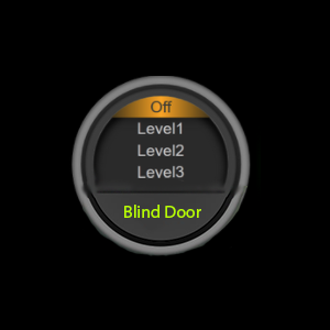

Hi Lokonli,
Is it possible to make the text size a bit bigger ?
When i try
The dial is meshed up a bit
Also is it possible to make the dial a bit larger
Width 3 is a bit to big and width 2 a bit to small
I'm trying to get 5 dial in 1 row
And is it possible to add Title to the Selector dial? Something like this ?
When i try
.dialbtn.up {
font-size: 150%

I've made a little update.madpatrick wrote: Friday 24 December 2021 10:04 Hi Lokonli,
When i tryThe dial is meshed up a bitCode: Select all
.dialbtn.up { font-size: 150% }
Now you can change the up/down text size via:
.up .text, .down .text {
font-size: 200%
- madpatrick

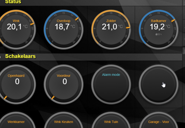

Hi Lokonli,
Another question (sorry for the many questions)
When I push 1 dial on or off the test will dissapear.
Same when i test it on my pc wih the mouse, but then i will come back if the mouse the not on the dial
What can this be ?
This is my custom.css for these dials
and i used in config.js
to remove the icon due to limited space on my small tablet
What can this be ?
.dial-center .value {color: white !important;font-size: 130% !important;}
.dial .device {font-size: 14px;padding-top: 10px !important}
iconSwitch: ' '- Attachments
- 2021-12-29 13_45_07-Dashticz.png (276.8 KiB) Viewed 1826 times
