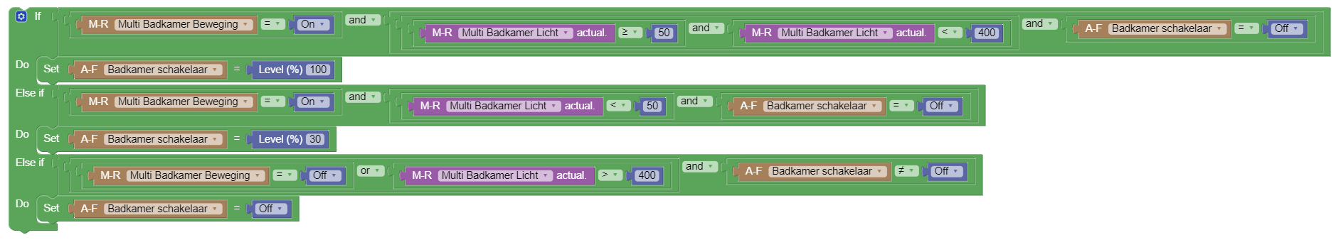

Until what time does "> sunset" apply? I mean: at about 22.00 it is past sunset. But at 3 in the night it is also past sunset. However, after 9.00 in the morning, it is also past sunset....past sunrise as well.
I am asking this, because I'd like my bathroom lights to switch on to 100% when it is daytime and to 10% when it is nighttime.
Is it also possible to check if it is 2 hours past sunset? Or do I just have to make sure the action set will happen "after x minutes"?

Quite weird to have a virtual switch to control an actual switch.
Anyway, thanks for the response, but I solved it by checking the LUX.
