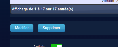

darrepac
Posts: 142
Joined: Tuesday 04 February 2014 21:31
Location: Isère, France
Re: Python plugin: Presence detection from wireless router
Post by darrepac »
EscApe wrote: Wednesday 19 January 2022 17:43
darrepac wrote: Wednesday 19 January 2022 17:12
EscApe wrote: Wednesday 19 January 2022 16:50 Update is fine. The “remove obsolete” setting determines what happens to devices that are no longer tracked.
Where is "udpate"?
Assuming you where asking about changing the devices to track: Go to the hardware settings for the plug in. Edit the “tags to monitors” field and press the update button. But maybe you meant something else? There is no “modify” button on the hardware settings page in my English Domoticz setup.
May-be I am facing poor translation problem. My setup is in french, when I go to hardware settings for the plugin, I have:
2022-01-19 17_46_54-Domoticz.png (6.06 KiB) Viewed 2202 times
which means "modify" (but could be update) and "delete". Is the one on the left the "update"?
EscApe
Posts: 538
Joined: Thursday 02 April 2015 8:46
Domoticz version: 2020+
Post by EscApe »
Looks like a different translation indeed. “Update” is “modifier”
