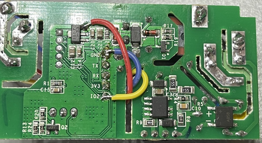

To all it may concern.
I have successfully connected the NPN sensor to a Sonoff Basic (R2).
Red wire is connected to 5v.
Blue wire is connected to GND
Yellow wire is connected to IO2
In the Tasmota software you have to select GPIO2 to counter.
I needed to compile Tasmota because I needed the condition function to have the updates sent immediately to domoticz.
This is done by a rule.
"Rule1":{"State":"ON","Once":"OFF","StopOnError":"OFF","Length":120,"Free":391,"Rules":"on Counter#C1 DO if (%var1% < %value%) publish domoticz/in {\\\"idx\\\":12,\\\"svalue\\\":\\\"%value%\\\"}; var1 %value% endif ENDON"}}
with this setup I reuse my existing Sonoff Basic (so it has 2 functions now) and have a neater solution.

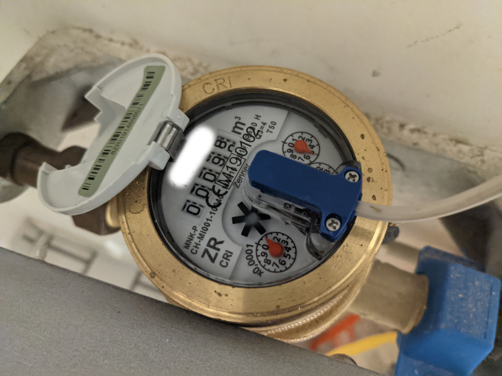

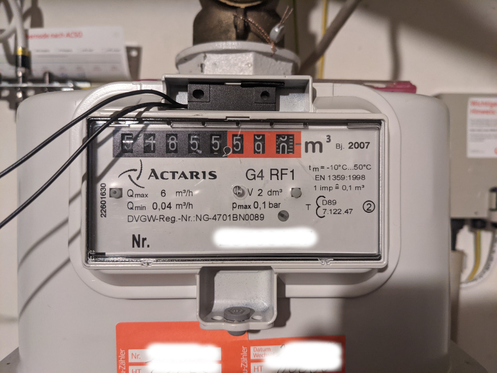

Hi, need to withdraw my post. I have now added 1K resistors to my sensors (water pull-down / gas pull-up) and seems working fine. I will need to check on a longer period to confirm that no fake counts occur. I also added some pictures from my Zenner water and Actaris gas counter...thanks again to akamming for the plug-in.GeyerA wrote: Thursday 25 November 2021 18:19Hi, I now also installed a Zenner NPN and did run with ESP8266 (espeasy) without problems. I sent the count to a virtual sensor and did not encounter any issues.JeeGee wrote: Friday 24 January 2020 19:35 My PNP with the plugin was running fine, but this week I had 3 times the issue that the measuring went crazy.
Examples: in one hour it said I used 400 liters, out of the blue and even one time 15.000 liters.
Tried to place the PNP a it different, but so far it didn't help.
Anyone else seeing this? And could be the cause?
I then thought lets hook up the sensor directly to PI running the plugin. I also get once or twice a day peak values of over 100 litres consumption although no water was used. I set-up the Telegram notification on "above" 100 litres consumption and that one even keeps on sending messages with the disabled plug-in (and disconnected sensor). I moved back to ESP8266 HTTP to Domoticz. In my opinion, this got nothing to do with sensor position since it works just fine on Espeasy, but same setup with plugin, twice a day peak values of over 100 litres. If somebody guides me to better logging I am happy to re-set up with plugin....maybe akamming is able to help.
BTW, using this reed sensor on the gas counter https://www.pic-gmbh.com/produkte/ms-332-3
UPDATE: Just got again a fake read of 250 liters water consumption; could it be that the pull up resistor is too small with 1K?
UPDATE2: Now changed to 10K resistor...
UPDATE3: Still had a fake reading on water sensor so displaced the raspberry away from any disturbances like NAS, power and network cables as well as network gigaswitches and managed to have one day without fake reading. I will keep you posted.
UPDATE4: Since the fake readings on water sensor did come back, I decided to move back to ESP8266 with ESPeasy. (pulse high on water and gas meter as well as 500ms debounce time).
UPDATE5: Fake readings still occurred also on ESP8266, seems the water sensor reading is the culprit. I have now connected the gas sensor on raspberry using the nice domoticz plugin and water on WeimosMini with espeasy. I also have to say that the external 1KOhm pull ups did not change anything so I am also using the internal pullups.
UPDATE6: It has now been working for nearly a week without fake reading. Seems, if I hook up both sensors on one device (regardless external 1kOhm pull-up or not), interferences will occur. Having it split, works fine.
- PXL_20211207_111742281s.jpg (220.86 KiB) Viewed 6953 times
