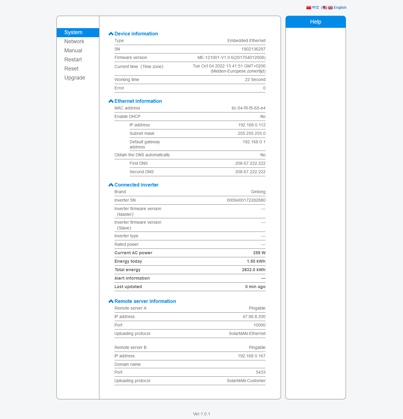

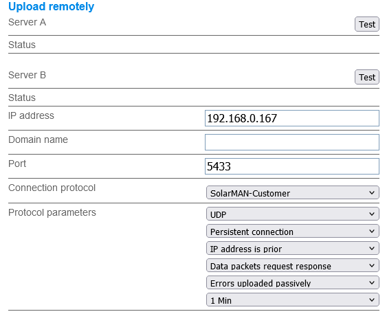

Application of functionality for Server_B requires that as sparring partner for the Solis-Inverter a computer is needed with a webserver.
As webserver/Server_B a setup with Raspberry & Buster & Domoticz probably is an easy candidate.
[Have rerun the previous experiments, but see no difference using UTP-cable instead of Homeplug]
[Running netcat according to this message just produces a totally blank log.txt => no operational interface]
Apparently a subtlety missing to link the Inverter and Server_B:
saw some remarks in other forums that 'some versions' firmware of the inverter not always active for this function, but how to check/remedy/upgrade?
Most elaborate description found for the SolarMAN-setup is in this pdf-file, but rather aged and not discussing Server_B, except perhaps a remark on page 36 with apparent meaning 'more of same as described for Server_A'.
Just some questions before starting effort, requesting some hints for realisation
(perhaps open door, but then consider it as request-for-confirmation, or rpi-webserver-for-dummies):
1. what is standard functionality for webserver available in Domoticz/Buster?
2. what/where settings in such configuration to modify to become compatible for data transfer from the inverter?
3. how to deal with incoming data as per selected protocol?
Addition October05,2022:
Small, italic text shifted from earlier message.
Discussion continued in this message
Last edited by Toulon7559 on Thursday 06 October 2022 14:44, edited 3 times in total.

Subject: Direct reading from SOLIS4GMini700
Still (unsuccesfully) trying direct reading the data for my Ginlong_Solis700-4G inverter, looking around for possible alternative approaches.
In Domoticz' wiki found under Plugins a contribution by sincze for direct reading of an Omnik-inverter:
https://github.com/sincze/Domoticz-Omni ... Web-Plugin and also packages at github:
e.g.https://github.com/graham0/ginlong-wifi ... ginlong.py , https://github.com/Nateonas/Domoticz_Dz ... arInvertor and https://github.com/simon3270/ginlong-python
With 2nd package and also 4th package (seeming the most recent development and best suiting my needs) got a pingable interface between the Solis-LANstick and the RPI at the LAN serving as Server_B with the following setup for the LAN-stick.
Solis_Inverter Setup
For Server_B with this settings for UDP in response to the advice in the READ.MD of the 4th github-package.
Setup_for_Server_B
Setup_for_Server_B
Considering resemblance between this group of inverters, tried the link mentioned in the github-packages:
http://<inverter-ip>/js/status.js
Calling my Ginlong-inverter/LAN-stick with that url-string yields a reaction, but different than expected.
var txt;var opt;function initPage(){txt=window.parent.reList().page.status;opt=window.parent.reList().page.option;for(var A=1;A<13;A++){inner("t"+A,txt["t"+A]);inner("p1_"+A,txt.pg1[A]);inner("p2_"+A,txt.pg2[A]);inner("p3_"+A,txt.pg3[A]);inner("p4_"+A,txt.pg4[A])}inner("p3_1_1",txt.pg1[6]);inner("p3_2_1",txt.pg1[6]);inner("p3_1_2",txt.pg3[6]);inner("p3_2_2",txt.pg3[6]);inner("p3_1_3",txt.pg3[4]);inner("p3_2_3",txt.pg3[4]);inner("p3_2_4",txt.pg3[5]);inner("p3_2_5",txt.pg3[7]);changeFont();child_getH()}function initData(){child_getH();ajax("status.json?CMD=inv_query&rand="+Math.random())}function ajaxReturn(B){if(B.time!=null){inner("gtype",txt.pg1["s3"]);inner("gsn",B.g_sn);inner("ver",B.g_ver);inner("time",new Date(B.time*1000).toString());inner("worktime",B.g_time+" "+txt.pg1["s4"]);inner("error",B.g_err);inner("mac",B.mac);inner("auto_ip",enb_txt(B.auto_ip));inner("ip",B.ip);inner("sub",B.sub);inner("gate",B.gate);inner("auto_dns",enb_txt(B.auto_dns));inner("dns",B.dns);inner("dns_bak",B.dns_bak);inner("type",reInvBrand(B.i_type));if(B.i_num==null||B.i_num==0){}else{show("inv_data",true);inner("list",B.i_sn);var A=[B.i_sn,B.i_ver_m,B.i_ver_s,B.i_modle,B.i_pow,B.i_pow_n,B.i_eday,B.i_eall,B.i_alarm,B.i_last_t];inv_data_show(A)}inner("ip_a",B.l_a_ip);inner("port_a",B.l_a_port);inner("agreement_a",agr_txt(9,B.l_a_agr));if(B.ip_b!=null){show("server_b",true);inner("ip_b",B.ip_b);inner("port_b",B.port_b);inner("domain_b",B.ipdm_b);inner("agreement_b",agr_txt(9,B.agr_b))}if(B.i_status!=null){if(B.i_status==0){show("inv_data",false)}else{show("inv_data",true)}}}if(B.conn_a!=null){initStatus("status_0",B.conn_a)}if(B.conn_b!=null){initStatus("status_1",B.conn_b)}}var sels=1;function upfold(A){var B=getCon("pg"+A);if(B.style.display=="none"){B.style.display="";getCon("p"+A).src="image/up.png"}else{B.style.display="none";getCon("p"+A).src="image/down.png"}child_getH();if(A==3&&B.style.display!="none"){ajax("s_ping.json?CMD=inv_query&server=110&rand="+Math.random())}}function inv_data_show(A){var D=new Array("list","mver","sver","inv_tp","rate_p","now_p","day_e","all_e","alarm","uptime");if(A!=null){for(var B=1;B<10;B++){if(A==""){if(isNaN(parseInt(A))){inner(D,"---");continue}}var C=A;switch(B){case 4:C+=" W";break;case 5:if(C*1==4294967295){C="---"}else{C+=" W"}break;case 6:if(C*1==4294967295){C="---"}else{C+=" kWh"}break;case 7:if(C*1==4294967295){C="---"}else{C+=" kWh"}break;case 9:if(getCon("list").innerHTML=="---"){C="---"}else{C+=txt.pg2["s2"]}break}inner(D,C)}}}function initStatus(C,B){var A=txt.pg3["s1"];var D=txt.pg3["s2"];if(B==1){getCon(C).innerHTML=A}else{getCon(C).innerHTML=D}}function enb_txt(A){var B=txt.pg2["s4"];if(A==1){B=txt.pg2["s3"]}return B}function agr_txt(C,A){var B="";if(C==1){B=opt[1];if(A==1){B=opt[2]}}if(C==3){B=opt[3];if(A==1){B=opt[4]}}if(C==5){B=opt[5];if(A==1){B=opt[6]}}if(C==7){B=opt[7];if(A==1){B=opt[8]}}if(C==9){if(A==2){B=opt[11]}else{if(A==1){B=opt[10]}else{if(A==3){B=opt[12]}else{B=opt[9]}}}}return B};
This reaction from my Solis-inverter does not provide info for settings like shown in sincze's referenced github-section,
