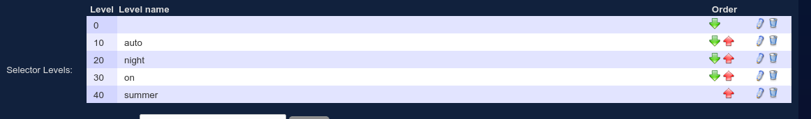

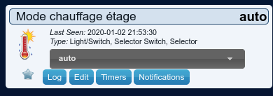

With blocky, when checking the level of a selector switch -> refer to level name, when setting the level -> refer to level value (this is NOT obvious). Example here: https://www.domoticz.com/forum/viewtopic.php?t=13317softone13 wrote: Monday 10 February 2020 20:13 Hi,
At the beginning I would like to say "thanks, good job" to the author.
I've made simple blockly to automatically change "HwcOpmode" from "manual" to "auto" after x seconds. When I change status to "manual" the event starts but status is not changing to "auto" after x seconds. But when I press "auto" mode on the selector switch for HwcOpmode device it's working so it's configured properly. What is wrong?
To see possible levels, click on "edit" of your selector switch:

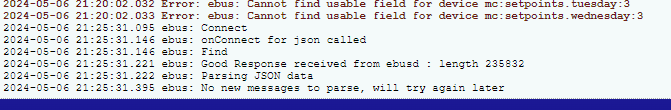

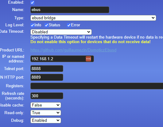

Hi. I try run this plugin but I don't see any devices
I have clicked "allow add device for 5 minutes" in settings.
Log:
Log:

Sorry but the log seems incomplete, could you post more, from "Search pattern is"? And you should have messages like "Add register" or "Cannot add register" at the end.fantom wrote: Monday 06 May 2024 11:02 Hi. I try run this plugin but I don't see any devices

This is still incomplete, I don't understand why, I expected to see the search and the exclude patterns. What did you use in "Registers" configuration of the plugin? Lots of messages are excluded...

This is whole log.
And after few hours:
2024-05-06 18:50:18.144 Error: ebus: Cannot find usable field for device mc:setpoints.thursday:3
2024-05-06 18:50:18.145 Error: ebus: Cannot find usable field for device mc:setpoints.tuesday:3
2024-05-06 18:50:18.146 Error: ebus: Cannot find usable field for device mc:setpoints.wednesday:3

No, some messages are missing, with the last version 2.0.4, between "Parsing JSON data" and the first "Look for register xxx" I should have "Search pattern is xxx" and "Exclude pattern is xxx", I need them to help you, or you must give me the content you have in "Registers" parameters of the plugin. Or you can click on "Modify" in plugin parameters, and you should see in log some messages like "This plugin is compatible with Domoticz version 2024.1 onwards" and other messages about plugin parameters that you could post here, that would be helpful. And this will restart the "Parsing JSON data" where you will see the search pattern and exclude pattern.
fantom
- Posts: 269
- Joined: Thursday 26 March 2015 10:40
- Location: Poland
Re: Python Plugin: ebusd
full log attached
The first "Parsing JSON data" will probably appear in a few hours.
EDIT: It appear now.
- 3.PNG (11.4 KiB) Viewed 2379 times
- 2.PNG (97.92 KiB) Viewed 2381 times
- 1.PNG (173.77 KiB) Viewed 2381 times
Barberousse
- Posts: 141
- Joined: Wednesday 02 December 2015 21:47
- Location: France
Thank you, I think I'm able to reproduce your problem. Could you try version 2.0.5?

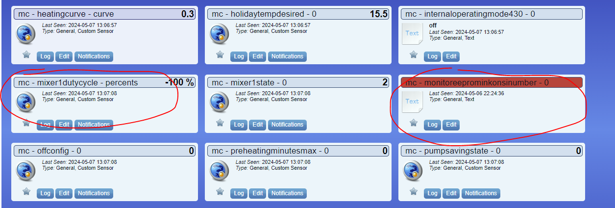

I have a few proposal:
1) not always temperature have correct device type (custom sensor instead temp sensor)
2) many devices have state like on/off, yes/no. Maybe they also should be contact type instead general text ? Unless there may be a third state there (auto etc)
3) device with percentage, can be percentage type instead custom sensor
4) many devices send data to domoticz only one time at start hardware (or maybe very rarely). Domoticz checks how long ago the data was sent and marks in red that there is no contact with the device. Maybe you need to send this data even though ebusd haven't changed it, etc.?
