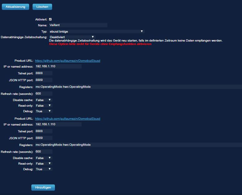

Gertschi wrote: Wednesday 23 January 2019 22:55 What am I doing wrong?
It could be a regression, what version of the plugin are you using? Could you post the content of http://IPOfEbusD:8889/data?def ?

Barberousse wrote: Thursday 24 January 2019 10:30
I think I see where the problem is, I can't access my github account right now, but you can replace
                            if bWritable:
                                #sTypeName = "Selector Switch"
                                iMainType = 0xF4
				iSubtype = 0x3E
with
                            if bWritable:
                                iSwitchtype = 18
                                iMainType = 0xF4
				iSubtype = 0x3E
in plugin.py, delete the device and restart Domoticz.

thanks for your answer!
This is my Version of the ebus deamon:
"version": "3.3.v3.3-10-gfa434e5",
Thit is from http://IPOfEbusD:8889/data?def ?:
Content.txt
(238.36 KiB) Downloaded 94 times
So I got it to work now!!! I do the upgrade in the plugin.py as you said. Thanks a lot!!
It wasn´t as easy as you would think, because I used the PPM for the ebusd bridge, so I couldn´t find the plugin.py. Now I installed the plugin manually, with the result that I have to fill in 2 entries in the plugin. But it works. :shock:

Gertschi wrote: Thursday 24 January 2019 15:48 It wasn´t as easy as you would think, because I used the PPM for the ebusd bridge, so I couldn´t find the plugin.py. Now I installed the plugin manually, with the result that I have to fill in 2 entries in the plugin. But it works. :shock:
You shouldn't have twice entries! Probably an interaction problem with PPM. I will integrate the correction in next version, in a few days.

Gertschi wrote: Thursday 24 January 2019 20:33 Thank you for this great work and for your help!!
I had some spare time this evening, the correction is integrated in version 1.3.7 of the plugin.

Barberousse wrote: Thursday 24 January 2019 21:03
Thank you for this!!! I updated now to the new version 1.3.7.
But with no success: The 2 inputfields was still there.
Now I deleted the PP-MANAGER plugin and the ebusd plugin installed from the PP-M plugin. Then I also deleted the DomoticzEbusd plugin, and restarted Domoticz.
cd domoticz/plugins
sudo rm -r PP-MANAGER
sudo rm -r ebusd
sudo systemctl restart domoticz.service
Then I installed like your instruction on https://github.com/guillaumezin/Domotic ... installing.
I dont installed the PP-MANAGER again , because I only used it to test some plugins.
Now it works pretty good for me!
