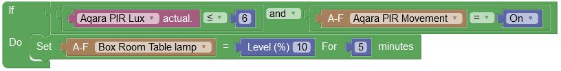

Strange, I have the Aqara sensor with the built in Lux level sensor and that definitely uses "on" for it's detected state - this is my blockly.
Dave

Nothing weird here. Time format. It must be in 5 minutes, not 00:05 because it's been 5 minutes past midnight

Well spotted !
