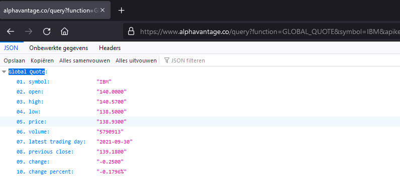

I would like to retrieve the price of a share every day and save it in a custom sensor.
I get the price with a json api call. I just can't manage to save the value after "02. open".
Does anyone have an idea?

How do I retrieve and save data behind "05. price"?
I am not very experienced with this format.

Should be something like below but it is not helping that the json field names have dots and spaces. So perhaps some special action is needed. I am also no expert.
if (item.isJSON) then
					local result_table = item.json['Global Quote']
					local price = result_table['05. price']

Thanks, that works perfect! :D
