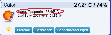

My sensor delivers combined temp/humidity as well as two separate values for temp and humidity.
Domoticz is calculating the dewpoint, see here:
Screenshot 2021-09-11 215514.jpg (19.8 KiB) Viewed 1426 times
So i defined
        local dewpoint = dz.devices(TEMPERATURE_SENSOR).dewPoint
and tried to log the value
dz.log('Current dewpoint: ' .. dewpoint, dz.LOG_INFO)
and get the error
2021-09-13 11:57:00.569 Error: dzVents: Error: (3.1.7) ...z/scripts/dzVents/generated_scripts/Klima Wohnzimmer.lua:52: attempt to concatenate a nil value (local 'dewpoint')
so dewpoint seems to be empty
