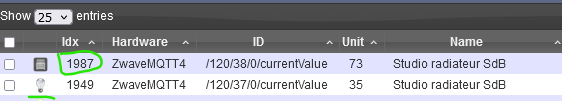

2 devices with different id but same name
     logging =   {   level   =  domoticz.LOG_DEBUG, },
		devices = {205},
	execute = function(dz, triggeredItem)
	    dz.devices(1987).switchOn()
before

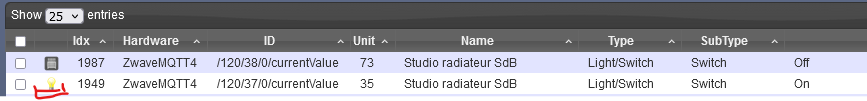

after

For some reason dzVents does not like the same names for different devices. It is a known issue. Easy fix is to rename 1 :-)

ok, but strange when you only use id in the script!
"For some reason" it is because inside the names are used sometimes instead of the id
"known issue" not for me ;-)
"Easy fix" yes after the diagnostic (1 hour) because I didn't jump on that conclusion immediately

The duplicated names are not the fault of zwave2mqtt, but mine.
zwave2mqtt initiated the devices with unique names, but I didn't like them!
I renamed some of them manually with temporary names to better understand the devices, and so I've set lots of duplicated!
I need to change them...
