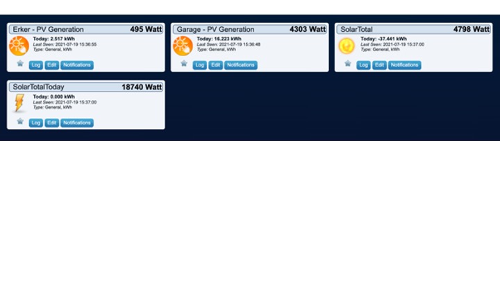

This is the output:
So the SolarTotalToday sensor is working as it is displaying the right value.
The 'Today' value in the SolarTotal sensor is constant at minus 37.441 kWh . So by the looks it starts at -37k and then adds 0 everytime the script runs. Hence the steady -37441.

hclardij wrote: Monday 19 July 2021 15:49 Hi,
I have tried that; I see a value but not the value that I want to see. This is displaying the total kWh that has been generated in its lifetime for both inverters.
This is because it is the first time you did the calculation. If you keep on sending the data it will behave exactly the same as your normal 2 single solar panel counters. So you have to be patient...... keep it running for a couple of days.
