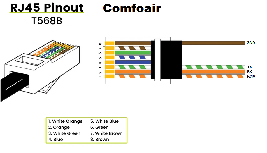

@rrozema, if you want to make it easy for yourself get a "db9 breakout connector" and a USB to RS232 DB9 converter. Then find yourself an Ethernet cable and connect it like this (TX/RX is from comfoair perspective):

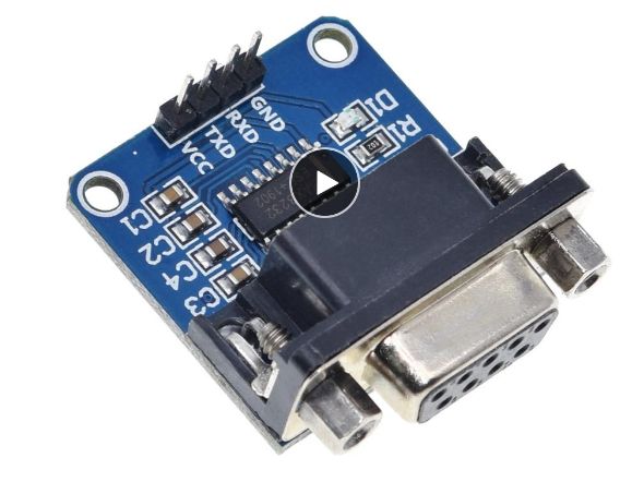

Thank you, I have ordered a max232 + db9 connector breakout board plus a db9 male connector so I can try it again using + and - 12v levels.
In this thread it is very hard to find any definite information on what exactly the connection type used by the Zehnder units is. Some say it's rs232, others claim it's rs485, some say it's ttl level and most people that have it working don't say anything at all about what protocol or components they use. And yet others fail to state what type of Zehnder unit they have (there could be different protocols used over different models?). If it is rs485 that my WHR930 Basic uses, (which I personally think would make sense looking at the descriptions of rs232 and rs485 and the intended use of the connection) will that max232 breakout board still work if it is rs485 and not rs232? I also have some usb <-> rs485 converters from my tests, so if I could use the same breakout board with those converters, that would be handy
Or would that require another converter like this??
I am going to try again using the usb-serial converter into rpi method once I receive these new components. But it's from aliexpress (it's still only a hobby), so it will take a couple of weeks before I can continue this.
I would also like to try and reproduce your method with the microcontroller. I already have mqtt setup and running for an esp32 switch (plus a HDMI-CEC-bridge I no longer use). Can you share which components you used and how you wired these together? It doesn't have to be anything fancy, a component list plus a picture of a simple pen or pencil drawn schematic will do. As long as all the components are in there, plus how they're wired together. I did do some experiments with esp32 and other micros in the past, so I have some wemos, arduinos, nanos, esp32's etc lying around. But the problem is I'm more of a software man, not an electrician: I can reproduce a circuit from a schematic, but I'm hardly able to check levels, let alone make corrections if something is wrong or incomplete.

That integrated max3232 is a great buy!
There is indeed too much confusion on this as TTL has been mentioned in this thread. The Zehnder manuals are clearly stating if it's RS232 or RS485. You'll be fine as our WHR 930/950 units are definitely equipped with RS232. (https://zehndernl.zendesk.com/hc/nl/art ... 0001309769). Confusion probably comes from some of the "Luxury" units that are equipped with RS485 as well.
That ESP32 of yours should work perfectly. My setup consist of a 3.3v DC-DC Step-down Buck (rated higher than actual consumption) Converter + esp8266 + MAX3232, basically something like this: (but of course fed with 24v):
Once you get it working you could try to install esphome and use the yaml supplied in my project. Of course you initially need to flash the esp32 with esphome from a serial ttl device, plenty tutorials are available on this. Let me know how this works out.

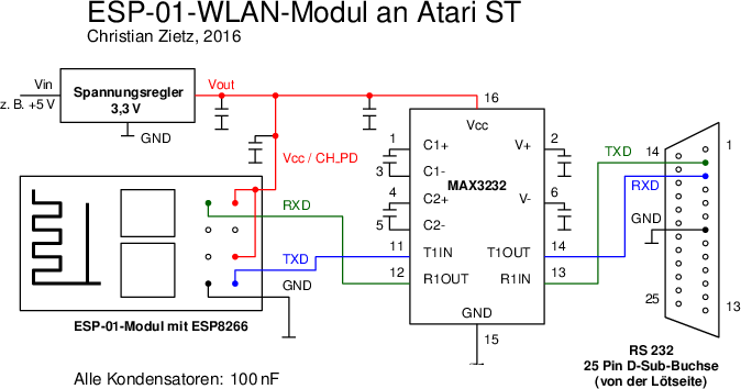

- rs232.jpg (43.99 KiB) Viewed 6994 times
Re: Zehnder/Stork WHR Ventilation Unit
@rrozema. I have exactly the same issue as you describe. Tried switching RX/TX on the RS232 cable, but did not help. Re-checked all the wiring multiple times, but without success. The windows software from Stork cannot make a connection with the WTW Unit (WHR930 Basic). It finds the com port, but nothing more. Did you make any progress after your last post, or are you still waiting on your order from AliExpress?

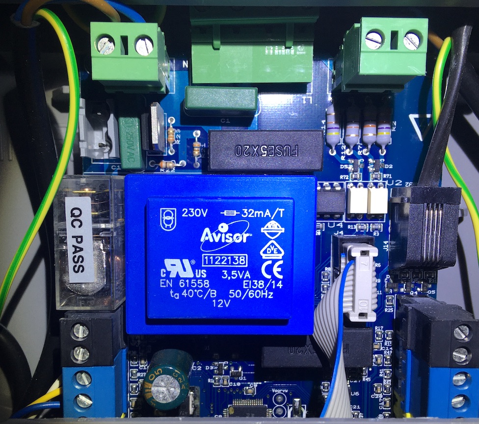

Hello everyone, I am stepping into this topic as a Newbie. I have a WHR930 and want this wired up to my Pi/Domoticz.
Weird: The controller board of my WHR930 does not have a RJ45 but a RJ10 (8mm width) with 4 contacts, see photo. (telephone receiver cable plug)
Which pin layout should I use? Yes, the connector is RS232, as the text on the PCB states, see photo.
An RS232/RS485 to USB lies waiting for deployment on my desk...
Kind regards, Dick.
