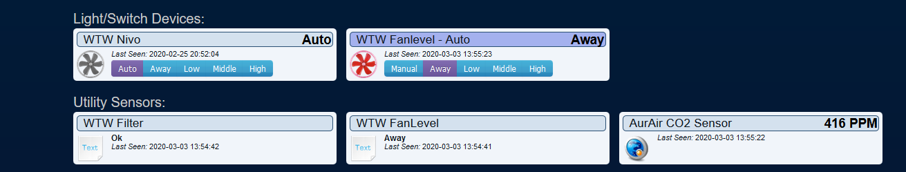

I have a Zehnder WHR920 Plus as a ventilation unit and I found this useful thread about a month ago. My primary goal was to control the ventilation unit based on the CO2 level.
My setup:
- Zehnder WHR920 Plus L
- 2 RFZ Sender transmitters
- 1 CC Ease Control Unit
- Domoticz
- 1 Domoticz integratable CO2 meter (AurAir).
- Sapiens script as described in the first message of this thread and found here on Github: https://github.com/AlbertHakvoort/Stork ... z-MQTT.git
- Raspberry PI Zero W hooked up to the serial port of the WHR920 via a USB to serial cable.
After making some changes to the original setup, my goal has been achieved! As a big thank you to Sapiens and the other folks on this thread, I decided to share my setup, hoping others benefit from this as well:

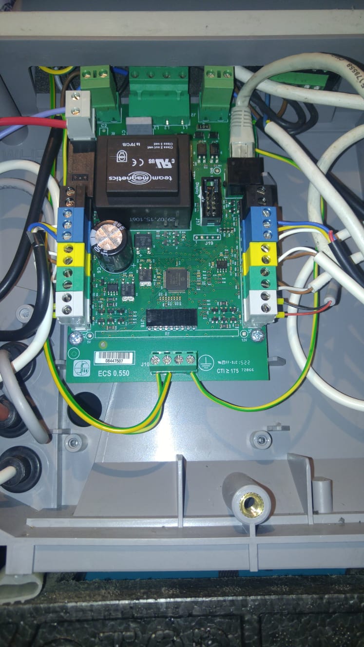

I have the same problem (WHR 950 II) with the exact same board layout as yours. I thought I had blown my port as well, so I replaced the PIC18F6622 and reflashed it with a PicKit2. Turns out it almost impossible for a pic18f to lose functioning ports and still have a working cpu.rrozema wrote: Sunday 30 August 2020 20:02 I have spent another sunday on this and I think I have to admit defeat: my WHR930 won't talk to me. I don't know what is wrong, but I've tried everything I can thik of and read here in this thread and it never responds.
As I've already dumped the firmware (I have version 1.4) https://pastebin.com/gy97ntD0 I thought I would do some reversing to see if there is actual uart code implemented. Good news there is, I have also verified that the baudrate is set to 9600. To be continued..
Re: Zehnder/Stork WHR Ventilation Unit

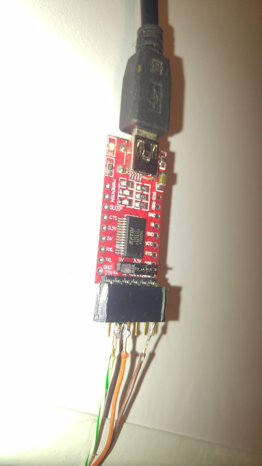

Ok, I finally got it working. I actually did break the RS232 logic conversion part of my WHR-950 Basic, I fixed this by replacing both the BC847B transistors. Now I can finish my esphome comfoair plugin.
@rrozema I noticed you're using the FT232RL chipset, this is for a TTL level device (0-5V), you really need RS232 (between +12V and -12V). If you don't want to buy a RS232 to USB dongle you could put a MAX3232 board between the FT232RL and the WHR.

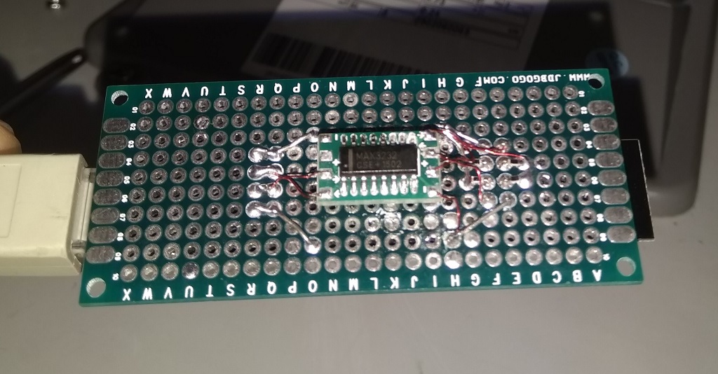

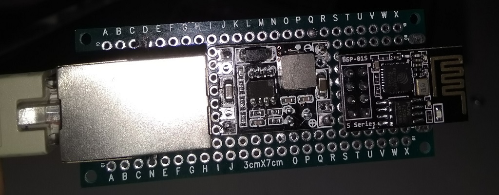

I have a working esphome comfoair plugin now. My esp is powered by the WHR-950 and is natively communicating with home assistant. Esphome can also talk to an mqtt endpoint, so this should work with domoticz as well..
Note: I destroyed the transistors on the WHR mainboard by using an RJ45 female connector with built-in ethernet transformers. I was not aware that they existed within the connector..
- 3.3 v converter and the cheapest ESP8266 I could find on aliexpress
