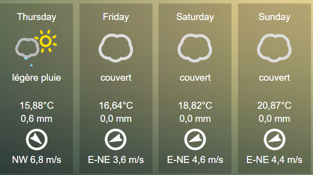

I have install the last version V3.8.2 beta
Now it is ok
Another question : Why are the days in English?
My config :
config['owm_api'] = '5xxxxx2';
config['owm_city'] = 'Rxxxxxx';
config['owm_name'] = 'Météo Rxxxxxx';
config['owm_country'] = 'be';
config['owm_lang'] = 'fr';
config['owm_cnt'] = '4';
config['owm_days'] = true;

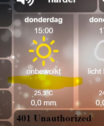

I tried all the CSS custom padding adjustments, but I can't get the yellow space smaller.
What is the code to remove this or make it smaller?
Or even better, set a fixed height to the block with all icons and text automatically adjusted to the right size... :)
TroisSix
Posts: 93
Joined: Monday 11 January 2016 9:29
Domoticz version: 2025.2
Location: France
Re: Dashticz v3.8.2 beta: New weather block
Post by TroisSix »
@whoami
You could try this:
[data-id='weather'] .max {padding-top:0px !important;}
[data-id='weather'] .description {padding-bottom:0px !important;}

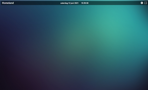

Still a blank screen as result:

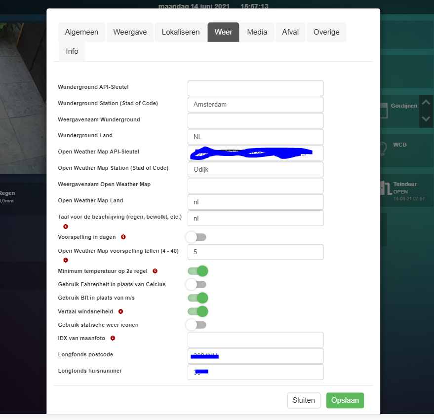

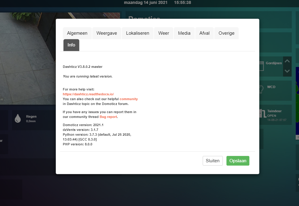

riko
Posts: 90
Joined: Saturday 22 August 2020 13:36
Post by riko »
Please see my version:
I was also able to see that the configuration was prefilled like this
madpatrick
Posts: 895
Domoticz version: 2026.1
Post by madpatrick »
riko wrote: Monday 14 June 2021 15:59 Please see my version:
As mentioned by Dicky, you probably need to upgrade to 3.8.3 BETA
You are on 3.8.0 master.
