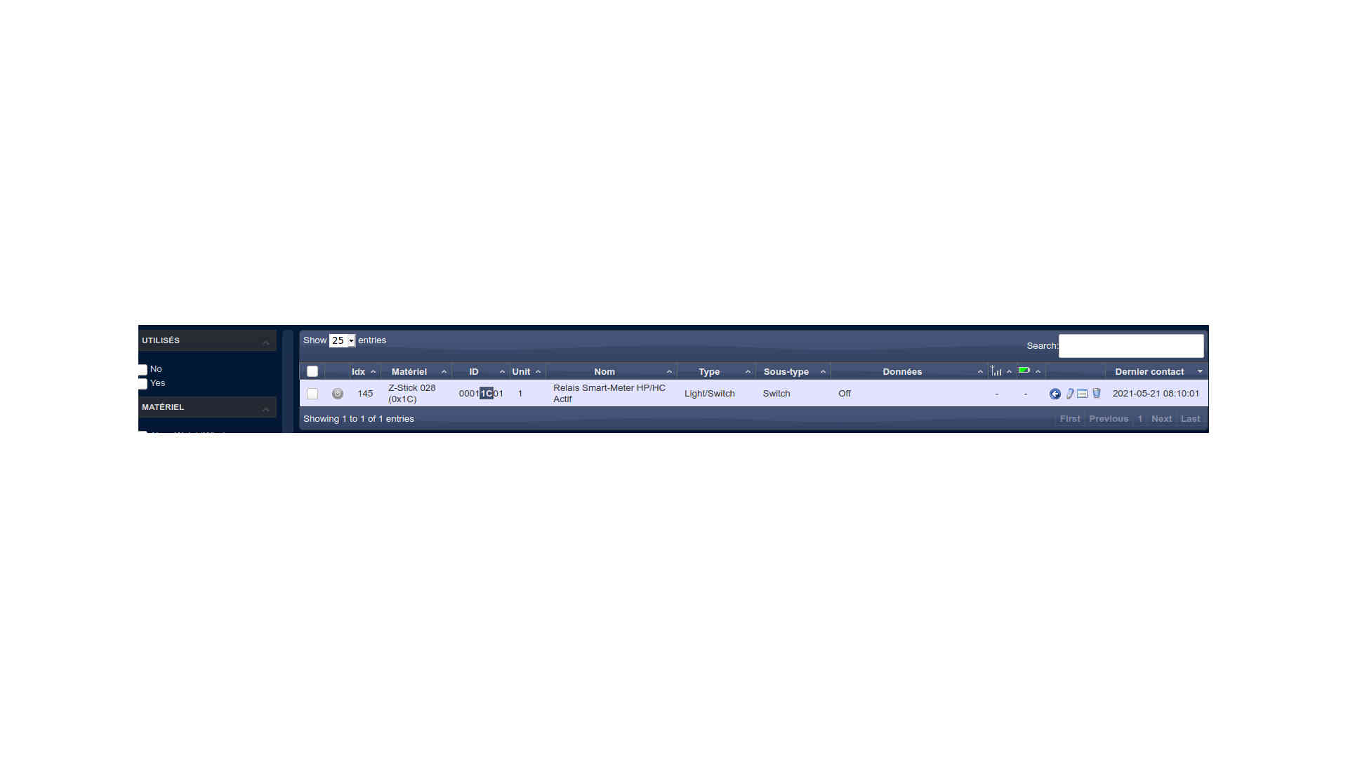

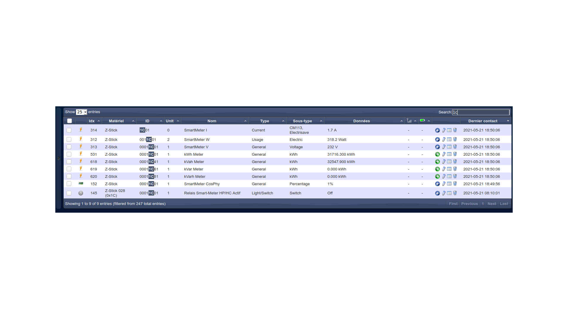

lost wrote: Friday 21 May 2021 7:25 Can't see how to put an image (needs an external URL) directly in the forum to show this, but that's what's happening.
You should see a tab with something like attachments. If you click that label you can add one or more (small sized) files. After adding you can place it / them inline

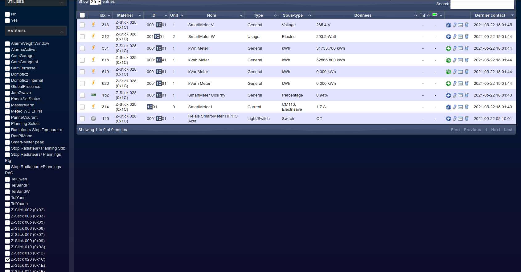

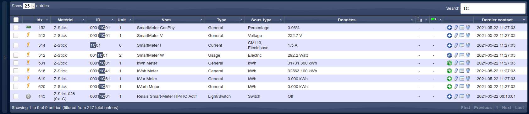

Here is the difference. Maybe something in the full pattern may explain this?
That's a bit bad on full image size, but copy/paste to gimp does this...
Re: Confused about which device belong to which zwave-node
Sorry but from this last image I cannot see which hardware filters are available and which ones you picked (you can pick multiple)

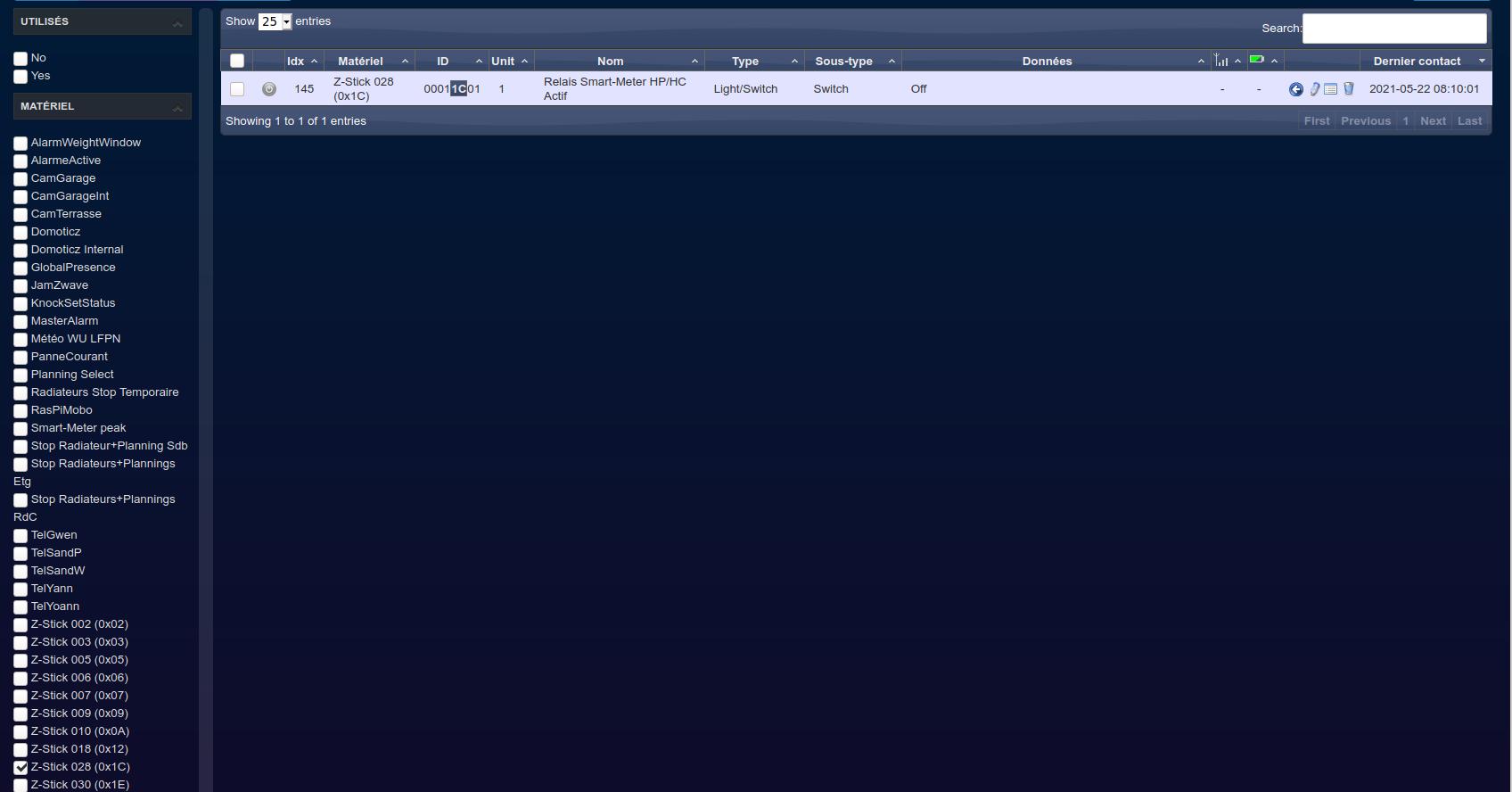

waaren wrote: Friday 21 May 2021 19:08 Sorry but from this last image I cannot see which hardware filters are available and which ones you picked (you can pick multiple)
Selection was only on the zwave node 0x1C, same as the one used in search mode:
These ones may be better (I'm Linux only, but found something better than GIMP for simple image editing as we have to use a intermediate file here, not just copy/pasting selection).
But, quite funny that 1st time this worked (all devices displayed in new filtered mode), second this was only showing 1 device as usual. So you may no see consistent re-creation of the issue???

lost wrote: Saturday 22 May 2021 11:33 But, quite funny that 1st time this worked (all devices displayed in new filtered mode), second this was only showing 1 device as usual. So you may no see consistent re-creation of the issue???
I understand now and see the same behavior on my system. The devices directly connected to the controller are not displayed when this filter is used.
I sent a comment about it to the developer who created this. Hopefully he can adjust the filter mechanism.

waaren wrote: Saturday 22 May 2021 12:29 I understand now and see the same behavior on my system. The devices directly connected to the controller are not displayed when this filter is used.
What's strange is, sometimes, this works after unselect/select same node again:
Anyway, thanks for linking these observations to the developer of this long missing feature!
