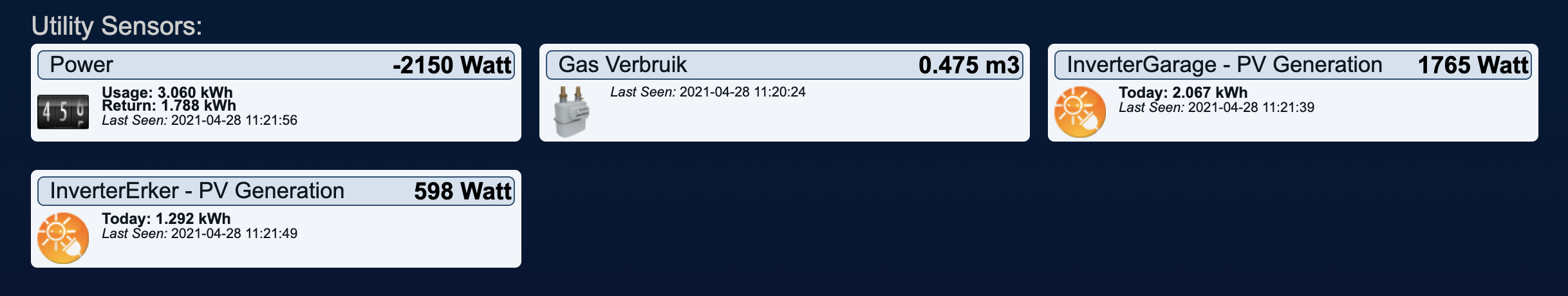

Do you use a p1 meter for the electricity? Can you see somewhere what the actual power is, when you deliver power to the grid? I'd say it should work with negative values.

Yes I do have a meter with P1 and I can see the actual value; If it is a negative number I am delivering to the grid.

So I did some testing and found out that the value has to be greater than 0. 0 is failing, but 0.001 is working.
My guess is that blockly is to limited in its capabilities.
