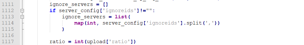

To tackle the issue I change the line 1112
ignore_servers = list(
map(int, server_config['ignoreids'].split(','))
and replaced it by:
ignore_servers = []
if server_config['ignoreids']!="":
This prevents the exception
Hoping it works for you too.
Best regards
meal

meal
Posts: 127
Joined: Monday 04 March 2019 14:59
Domoticz version: 2025.2
Location: France
Re: How to monitor your internet connection with virtual custom sensors
Post by meal »
You have to replace the spaces by tabs to avoid the indentation problem.
I am using the text editor Notepad++ (in the Edit menu you will find the way to transform spaces by tabs).
Best regards
meal
meal
Posts: 127
Location: France
Post by meal »
Here is the piece of code
Best regards
meal
Gravityz
Posts: 767
Domoticz version: 2026.3
Post by Gravityz »
tried it again without luck. maybee drop your speedtest.py
another question, this thread is 13 pages long. why on earth is this problem not solved in the source
meal
