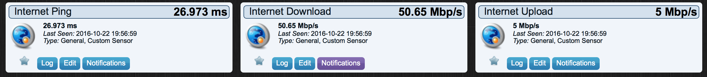

If setup correctly, domoticz will receive your results from speedtest every hour:

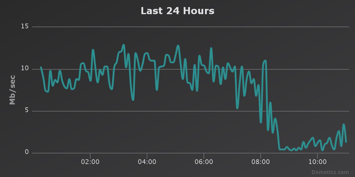

Why every 5 minutes? Why not? Ok because it uses up my bandwith, but a realtime monitor would allow me to spot issues early and sort them out.
I have both a fibre and an over the air long range wifi-connection. While speed at one time can appear to be fast, I still to see stuttering on streaming services etc., so I was trying to see if there was anything systematic - farmer moving tractor into line of sight, wind blowing trees into line of sight etc..
So I am not sure once an hour is really useful to track long term trends, but not really useful to me for intermittant faults, as fault could already have happened 55minutes ago, and more annoylingly I could leave home after fault has occured without realising, so could have fixed it if I had known. Basically speed test is not the not the way to do it, I really need access to ISP network infrastructure as this will have the information I need on quality of connection with no unnecessary bandwidth.
For example, this morning
my speed has dropped from 10 to <2Mbps, I have no idea why, no wind no rain no obvious obstructions, but lets see what ISP says.
I am running on Raspberry Pi, I got speed-test from https://www.npmjs.com/package/speed-test.
I had forgotten my code is largely copied from viewtopic.php?t=11970#p86162 which has a lot more discussion of measuring network speed.
