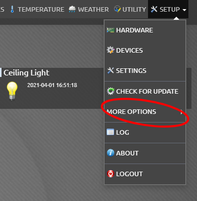

hello,
i have 1 little problem.
in domoticz, how i add rules and set rules ?
https://ibb.co/0rPd67V

Re: Capacitive Soil Moisture Sensor Wemos ESPeasy
Post by EDsteve »
i also use Domoticz. But your posted img doesn't look familiar to me. Are you sure you are using Domoticz?
In Domoticz you can add rules under:
Setup -> More Oprions -> Events
