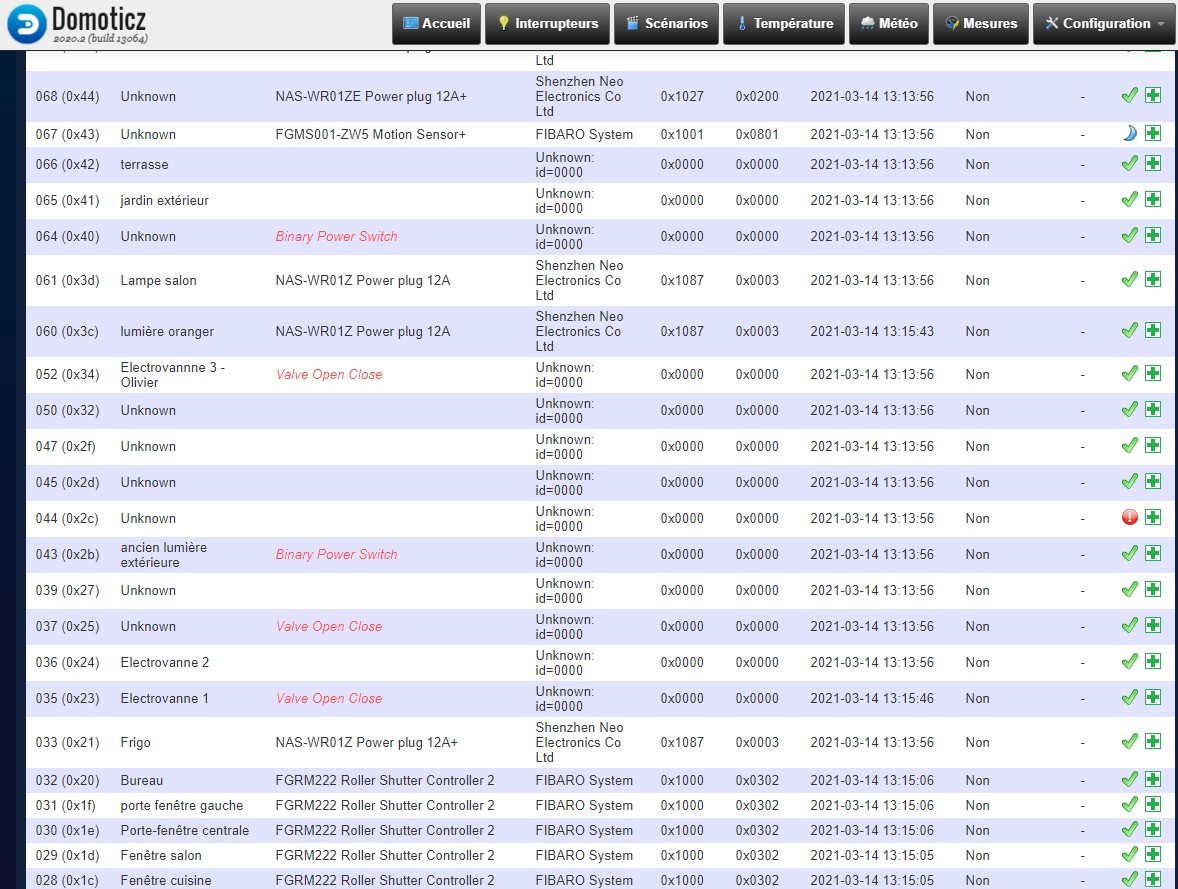

Thanks to you, I was able to restore some of my lost devices !roblom wrote: Saturday 16 January 2021 10:58 Before remove and adding them again, try the "refresh node info". Most of the time this works for min system.
- Hardware
- Zwave settings
- Node management
- Control panel
- click on "select operation"
- choose "refresh node info"
- select a node from the list which it's not working correct.
- click on "Go" (behind the "refresh node info")
Do this for all nodes that are not working and wait half an hour or so. For me this brings back the nodes again most of the time (not always). And I'm aware that there is also a refresh node button in Domoticz self but for some reason this does not the same because in my experience is that clicking on this button has no effect at all.
Before : After : Now I would like to delete from my zwave key the old devices that were broken or sold. I tried to do a delete device in CP, but did not work.
Do you know a better method ?
