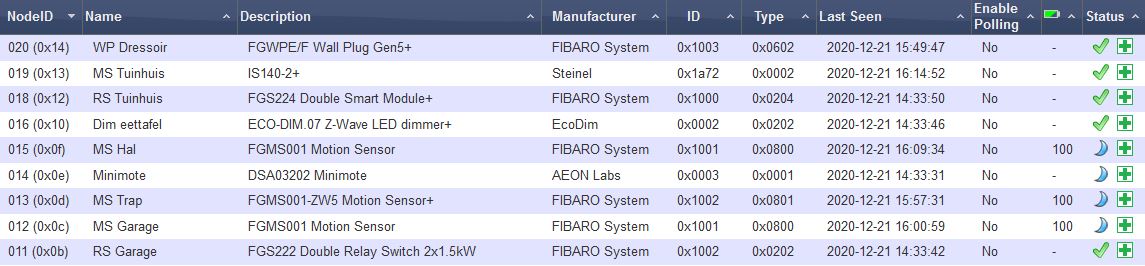

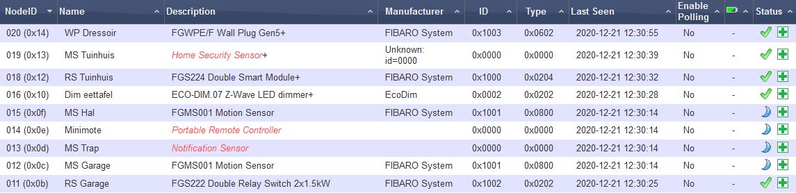

I was able to repair node 19 (Steinel IS140-2) by using the OZW control panel and turn on the switch from there. This somehow triggered Domoticz to recognize the hardware again. The configuration values in Domoticz were still default but fixed after clicking on "Request the current stored values from the device".
After re-including the Minimote (node 014) as a secondary controller without doing an exclude first, the Minimote was recognized again by Domoticz and the button definitions were still in place.
The Fibaro Motion Sensor (node 013, MS Trap) apparently healed itself after a while probably because it woke up and did some activity.

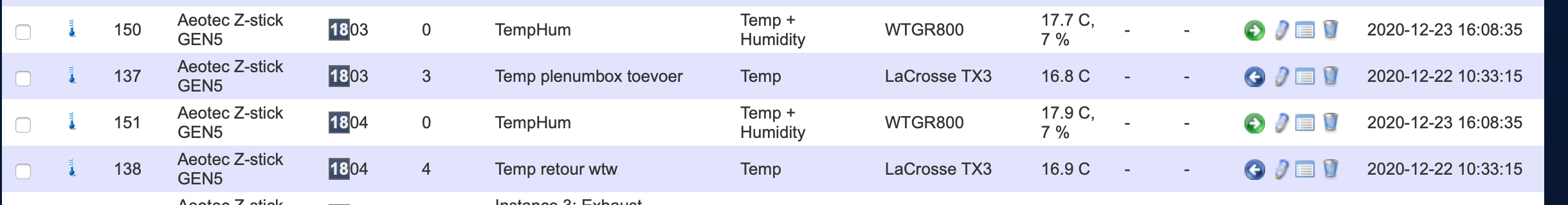

I have some annoyances too wrt z-wave. And they take too much time fixing it. It's frustrating. What I experience is that devices pop up out of nothing. In my case this only happens with temperature sensors on a Fibaro Binary Sensor (FGBS001 type 501 id 1002). It is not battery-powered by the way. In the screenshot you see 4 devices of which two are included (137 and 138). These have worked fine for months and yesterday suddenly stopped reporting. So I take a look at Domoticz and guess what. Two new devices (150 and 151) have been created, not by me. Yes, they report the correct temperature. But the humidity is wrong because the sensors do not register this. No idea where this comes from. I don't know why the former are called LaCrosse TX3 and the latter WTGR800.
Schermafbeelding 2020-12-23 om 16.09.19.png (160.56 KiB) Viewed 8013 times
When this happened before, the z-wave configuration file seemed altered (zwcfg_[id].xml) and I replaced it with an earlier back-up. The problem was then fixed for some time. However, now I discovered that the config-file hasn't changed and replacing it makes no sense so something else must go wrong.
Question: how can devices have the same ID such as in the screenshot? If I delete one, than a new one is automatically created with the same ID (though with a new IDx). And does 'unit' in the devices-screen correspond to 'instance' in the z-wave configuration file? My guess is that something gets 'lost in translation' between z-wave communication and passthrough to domoticz.
I have loads of z-wave sensors, switches and actuators ( a small fortune) so would really be happy when this could be solved.
