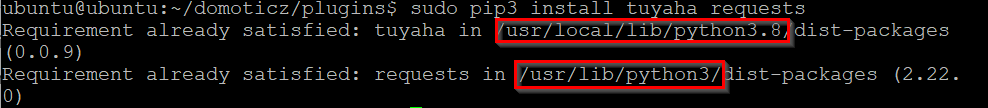

This are the versions on my machine.
sudo pip3 install tuyaha requests -U
Requirement already up-to-date: tuyaha in /usr/local/lib/python3.7/dist-packages (0.0.10)
Requirement already up-to-date: requests in /usr/local/lib/python3.7/dist-packages (2.25.1)
Requirement already satisfied, skipping upgrade: idna<3,>=2.5 in /usr/local/lib/python3.7/dist-packages (from requests) (2.10)
Requirement already satisfied, skipping upgrade: certifi>=2017.4.17 in /usr/local/lib/python3.7/dist-packages (from requests) (2020.11.8)
Requirement already satisfied, skipping upgrade: urllib3<1.27,>=1.21.1 in /usr/local/lib/python3.7/dist-packages (from requests) (1.26.2)
Requirement already satisfied, skipping upgrade: chardet<5,>=3.0.2 in /usr/lib/python3/dist-packages (from requests) (3.0.4)
I see a path and python difference in you screen shot.
2021-02-01 21_02_44-Clipboard.png (18.27 KiB) Viewed 4036 times
Looks like that requests is installed on a older python version, I don't know the solution. You can try uninstall and reinstall it, on you own risk 😅.
sudo pip3 uninstall requests
sudo pip3 install requests
