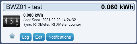

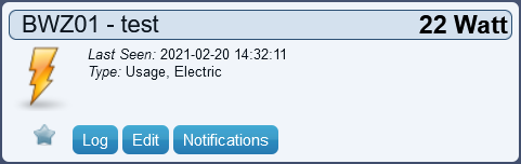

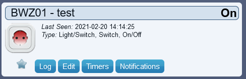

Thanks! Don't know the cause but simply deleting the switch and recreating it from settins/devices solved. Now it became a true switch which I can operate. See the images below.
Sometimes solutions are soo simple ;)
The energy monitoring is also shown (although I do not see the energy sensor in Phoscon. Not a big deal as all real monitoring is done in Domoticz. kWh meter was added too.
