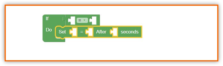

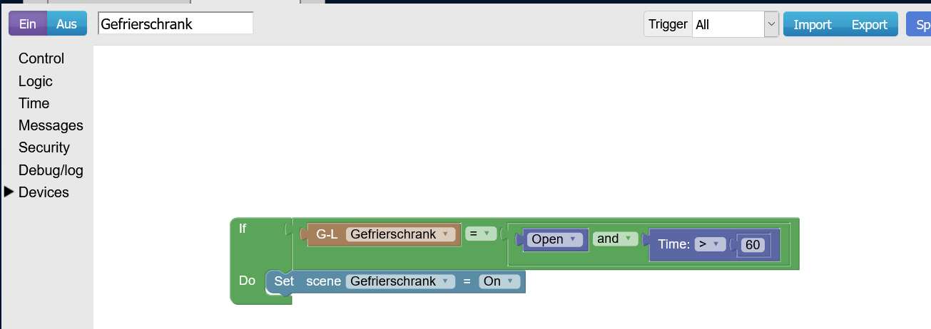

Have a Door Contact
I would like that at a time after 60 seconds a lamp turns on.
When the freezer is open for 60 seconds, I want a lamp to turn on in the living room.
Unfortunately I do not get that.
Selly recognizes correctly open and closed.
I can also connect a lamp to it, but not only after a certain time.
If only briefly the door is opened and closed, no message should come, hence the 60 seconds.
Have a Door Contact
- Selly.png (38.63 KiB) Viewed 2840 times

Re: Python Plugin: Shelly MQTT
I had the same idea.
But you can't make a Group or Scene with it.
Try to make a virtual switch with the Timer PlugIn, maybe it will work. Otherwise you have to ask the guys with Dzvents!
https://github.com/skarab22/Domoticz-sy ... ree/master
