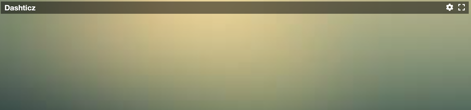

But when adding example blocks & columns, just a blank screen is shown:
var config = {}
config['language'] = 'en_US'; //or: en_US, de_DE, fr_FR, hu_HU, it_IT, pt_PT, sv_SV
config['domoticz_ip'] = 'http://***.***.***.***:***';
config['user_name'] = '****';
config['pass_word'] = '****';
//config['use_favorites'] = 0; //Request all Domoticz Devices, not only favorites
//config['auto_positioning'] = 0; // Use 0 this if you have defined your own columns
//Definition of blocks
blocks = {}
blocks[3] = {
  width: 6
blocks[34] = {
  width: 6
//Definition of columns
columns = {}
columns[1] = {
  //In this example: No blocks are defined in this column
  //This column will be empty
  width: 4
columns[2] = {
  blocks : [3, 34],
  width: 8
//Definition of screens
screens = {}
screens[1] = {
  columns: [1, 2]
Blank screen with blocks in custom.js
With blocks.png (253.22 KiB) Viewed 462 times
Cannot figure out what's going on, probably too simple but I'm lost - any pointers?
Lokonli
Posts: 2292
Re: Getting started, basic setup not working
Post by Lokonli »
I guess device 3 and 34 are not marked as favorite in Domoticz.
Remove the two slashes before the config parameter, like this:
johansson
Posts: 75
Joined: Sunday 27 September 2015 15:52
Location: Finland
Post by johansson »
Thanks for the tip, but unfortunately no help - one of the other was marked as favorite, the other one not. Choosing two non-favorite ones and removing the slashes had no impact, neither did two favorites with or without the slashes. I'm sure the solution is obvious, but I'm just missing something.
Lokonli
Posts: 2292
Post by Lokonli »
There is a bug in beta: Each column must have a parameter 'block'
The block array can be empty, like this:
columns[1] = {
   blocks: [],
   width: 4
but the blocks parameter must be present.
johansson
Posts: 75
Location: Finland
Post by johansson »
Indeed, that was it - great, thanks! Now at least (only) the test devices are seen in Dashticz.
