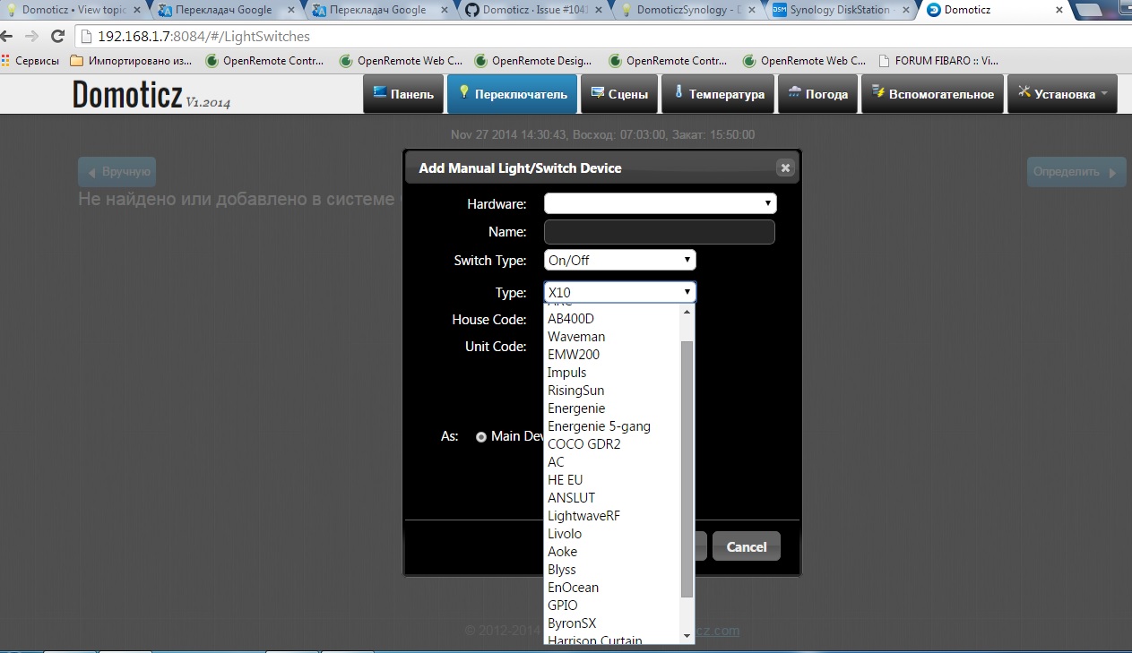

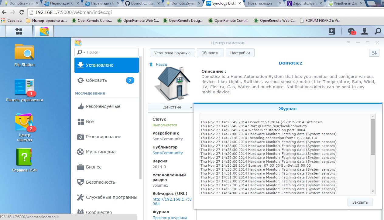

Post by tehnoinstyle »
Tried your application, install it without problems, even a Russian language pack! This is great! It is a pity that I can not connect their ZWave devices. Really need support ZWave.

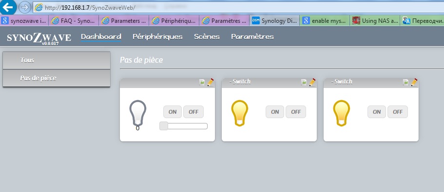

kaivalagi wrote:
tehnoinstyle wrote:Please let me know if there is a complete package with support for Z-Wave.
Why not install the OpenZWave drivers through their package repo here: http://repo.synozwave.com
package SynoZwave and Driver are installed and working properly. With these same drivers works and the application Openremote also installed on ds214play. The point is there is no ZWave library in Domoticz.

Post by jorik »
I meant the description in your screenshot:Image
"Domoticz is a Home Automation System that lets you monitor and configure various devices like: Lights, Switches, various sensors/meters like Temperature, Rain, Wind, UV, Electra, Gas, Water and much more. Notifications/Alerts can be sent to any mobile device."

jorik wrote:I meant the description in your screenshot
"Domoticz это Система Домашней Автоматизации, которая позволяет отслеживать и настраивать различные устройства, такие как: Димеры, Переключатели, различные датчики/измерители Температуры, Осадков, Ветра, УФ, Электричества, Газа, Воды и многое другое. Уведомления/Сообщения могут быть отправлены на любое мобильное устройство ".
