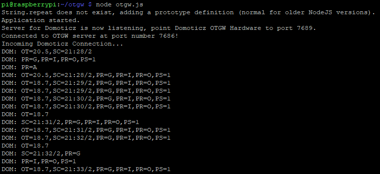

I'm having problems with my OTGW and Domoticz (as already explained in other topics). (Very) short version: When running the OTGW with OTMonitor everyhing is fine, but when I connect Domoticz to it, it only gives me the messages that start with B or T.
sincze pointed me to this topic, and I have tried the node.js-script. When I run the script (I'm using Putty), I see only one message in the domoticz-log:
OTGW: connected to: 127.0.0.1:7689
I see the script running in Putty, but nothing happens within domoticz. Very strange. Can anybody think of a reason for this?

I updated my Opentherm Gateway over the weekend to 5.2. I couldn't find the previous version, but I expected 5.0 or 5.1.
From that moment my solar boiler reported 0.0'C in Domoticz, but still the correct temperature in OTmonitor. It scared me, since I had replaced a faulty temperature sensor in the solar boilier just that same afternoon. To find a 0.0'C temperature in Domoticz wasn't funny.
Anyway, after comparing, splitting the PS=1 string etc. I was 'rescued' by my own input here above: I obviously didn't run a +5.0 firmware, because the otgwmod was using position 11 for solar temperature ID=29. Position 11 originally was used for DHW temperature, which my boiler doesn't supply. I used that position for the solar boiler instead, using the same type of temperature sensor in Domoticz.
After I put ID=29 on position 15 and the sample change (ID=29) from position 12 (<5.0 version) to the current (+5.0 version) position 22, Domotidz was happy again.
in OTGWmod.js I also change the code tmp.length == 25 to tmp.length == 34 to meet the current PS=1 length.
Summary:
OTGWmod works just fine in +5.0 versions of the gateway as long as:
- New position in the PS=1 string is used for the value that needs to be replaced
- tmp.length == 25 is changed to tmp.length == 34
