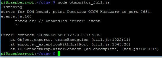

I tried the script from ernorv on my RPI but I have some errors that I do not get solved.
Can someone explain to me what I do wrong
should I set anything else on RPI or domoticz. (preferably as sreenshot)
I am a beginner sorry if I ask a stupid question.

@heelderpeel have a look at the updated code, should be a lot user friendlier without that kind of errors.
Heelderpeel wrote:I tried the script from ernorv on my RPI but I have some errors that I do not get solved..
Looking at the error, node can not open the TCP port, probably because somebody else is already using it: otmonitor itself.
Did you set all the port correctly?, i.e. at the top of the script we have:
const portNumberForDomoticzToUse = 7686;  // if otmonitor is already using this one, choose another!
const portNumberOfOtMonitor      = 7685;  // most of the times 7686 would be used for this one
const replaceTTwithTC            = true;  // set to false in case you would like to use TT,
the 'portNumberOfOtMonitor' must be aligned with your 'otmonitor' setup. you could try looking in the otmonitor webpage if you have this one, under the configure tab (web page looks something like: http://raspberrypi:8081/configure.html where you replace raspberrypi with the IP adress). There you see on the left side a tab called Remote Access. Make sure the 'Relay Server' is checked, and make a mental note of the port number directly below. You can also find this in the otmonitor configuration file directly on your PI, e.g. /home/pi/otgw/otmonitor.conf , note that actual path depends off course on your installation.
Use this port for portNumberOfOtMonitor. Now the application is able to connect to the otmonitor application itself.
Probably you now have twice the same port number, so we need to tell domoticz to use a different one. First change the portNumberForDomoticzToUse to a free number, e.g. 7689. Now try to run the js file. If this works, go to your domoticz and change the port number for the OTGW under the Hardware tab (make sure to update the device ;) )
Hope this helps
