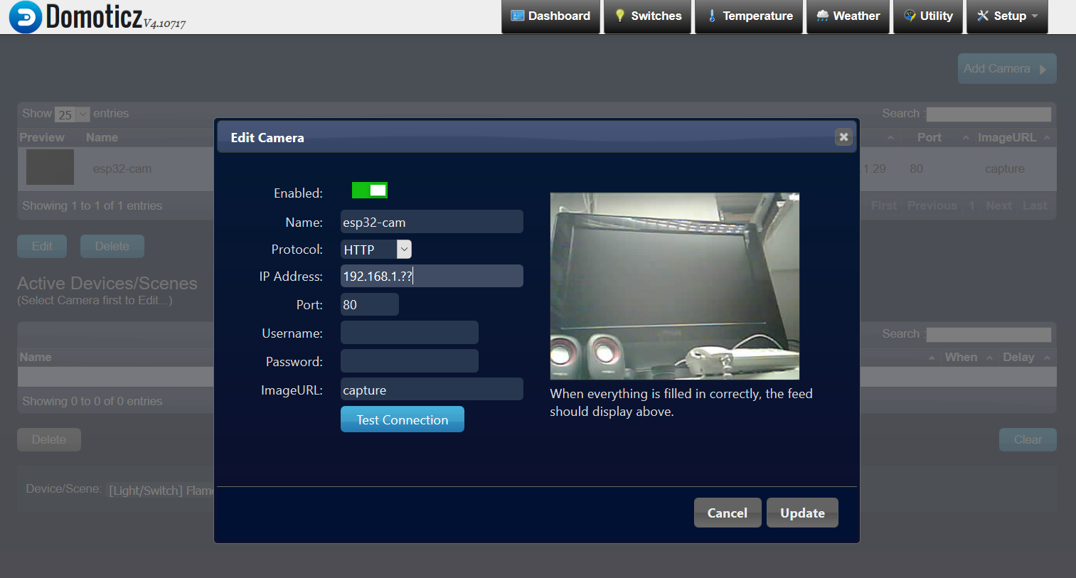

As far as i know the ESP-32 cam is working with:
http://192.168.1.20:81/stream
http://192.168.1.20/capture
http://192.168.1.20/status
So i fixed the stream with the next configuration.
screenshot domoticz esp32-cam.PNG (240.44 KiB) Viewed 24243 times
For me the stream is working.
Bur for unknown reason the screenshot function gives a .jpg file to save, but the content is not a picture.
With kind regards,
WimT

That doesn't work for me. What software did you flash on the ESP32?

I used the website https://robotzero.one/esp32-cam-arduino-ide/
The software came up with the arduino tool, so called "CameraWebServer", i cannot find a version number.
My board is a ESP32-S AI-Thinker.
Kind regards,
WimT

WimT wrote: Sunday 23 June 2019 13:41 I used the website https://robotzero.one/esp32-cam-arduino-ide/
Thanks, flashed it and it works!

OK. So I have Domoticz installed on a Win10 PC. I have two ESP32 Cam boards, both of which appear on my network, and can be viewed locally in Chrome browser windows. Using Setup>More Options>Cameras >Add Camera in Domoticz and then filling in address, port, and "capture" as the image URL, the stream appears ok for both cameras on the two different addresses. When these are saved, they then appear in a list on that page, and if the "Stream Video" icon (spherical camera) is clicked for either, a live stream is displayed. So far, so good …
But having got to that stage, what do I do next to make these devices visible to the outside world ? I have Domoticz installed on my iPhone and can log into my dashboard page, but cannot reach the page where the cameras appear on my PC. A bunch of little squares with no icons in them appear on the left side of the screen, and these would seem to correspond to the buttons under "setup" on the PC app. However, the fourth one down which should be "More Options" from where you would be able to get to "Cameras", does nothing. Am I doing something wrong, anyone ? Or better yet, how can I get the 'found' cameras in my list, to somewhere else in Domoticz that can be seen by the remote iPhone app?
