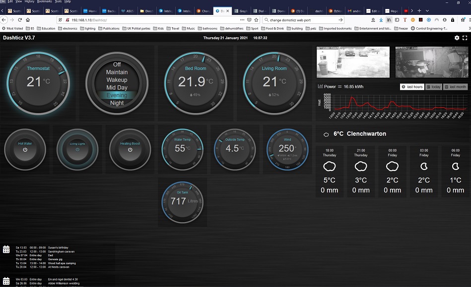

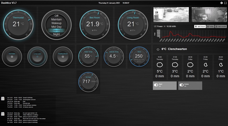

I have spent several hours building my first Dashticz display. I have just about got my head around the layouts, but have hit an odd problem.
my latest blocks show the prescence of myself and my wife, these are dummy switches activated normally via geofencing, and all is well on the Domoticz front.
The issue is that these blocks (have also tried substituting other switches) do not show up on the Dashticz screen UNLESS I change the state of the corresponding switch in Domoticz.
Once it shows up in Dashticz, it functions as one would expect, but then disappears if I refresh the Dashticz browser page, but will reappear if I change the switch state again.
The logic level doesn't matter it is the change in state which "allows" the Dashticz block to become visiable.
Screenshots and my messy config enclosed
Help?

dashticz Showing.jpg (146.42 KiB) Viewed 360 times

dashticz missing.jpg (170.32 KiB) Viewed 360 times

In your config set use_favorites to 0, or make your devices a favorite in Domoticz.

Brilliant! That worked.
