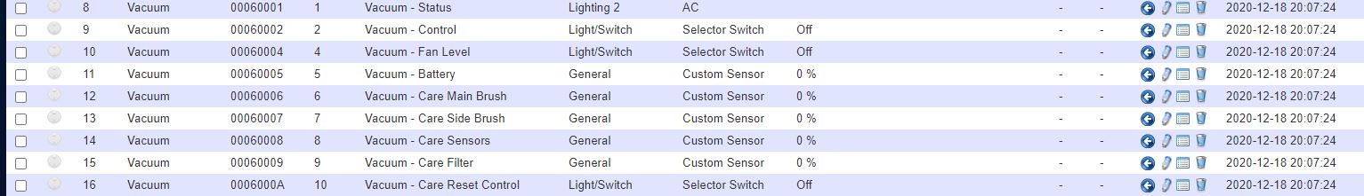

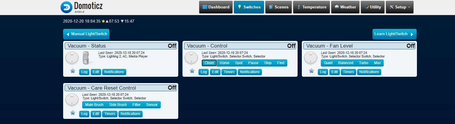

I have tried to add my Mi Robot to Domoticz exactly like in the instruction, but something is wrong.
Please see attached files.
What can be wrong?

Post by HFman »
Did you check the Domoticz LOG ?
Can you connect mannually to to the robot ?
