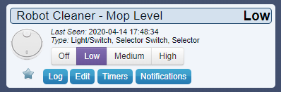

Short status update :
Updated the Fan module for S5 Max :
Added Error (can reconize 26 different error's)
And implimented the Mopping :
Still to do (50% ready) :
- add water container detector
- add mop detector
After this still will have a look on cleaning a room.
