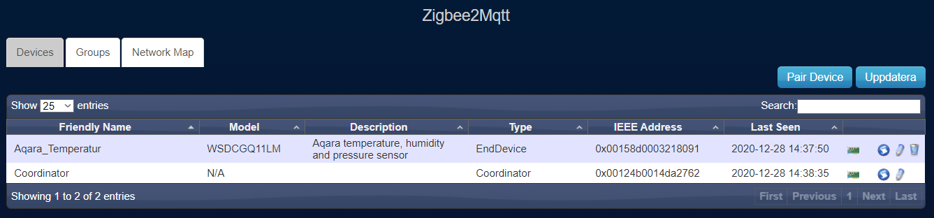

But, it looks like Domoticz can see the sensor in right way....
2020-12-28 14_45_11-Domoticz - Opera.png (42.22 KiB) Viewed 567 times

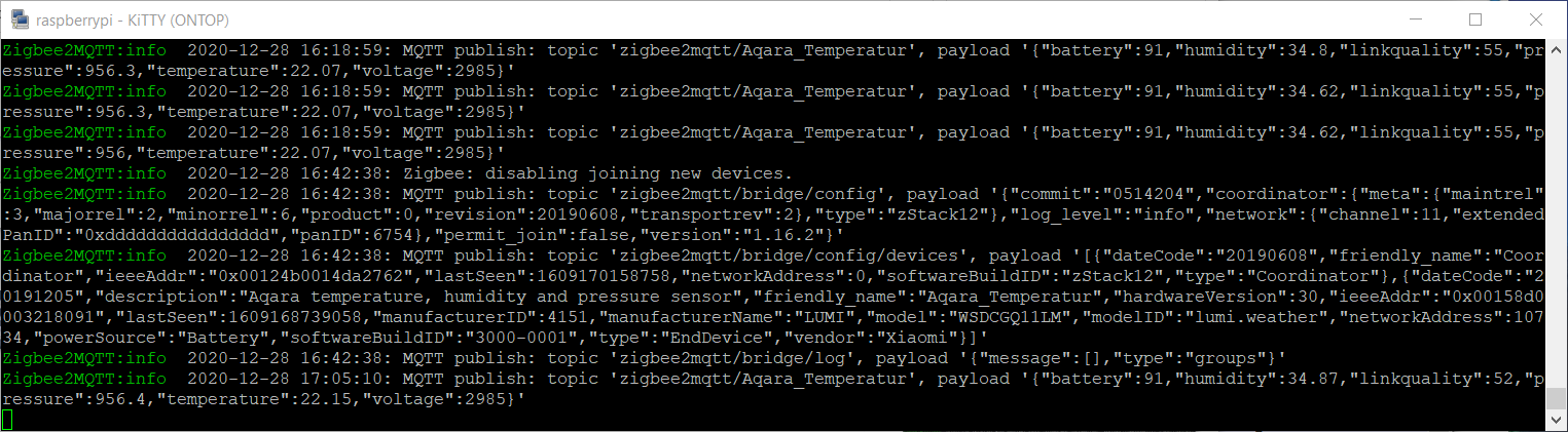

All works fine in server as you can see in picture.
2020-12-28 17_17_38-raspberrypi - KiTTY (ONTOP).png (77.61 KiB) Viewed 567 times
