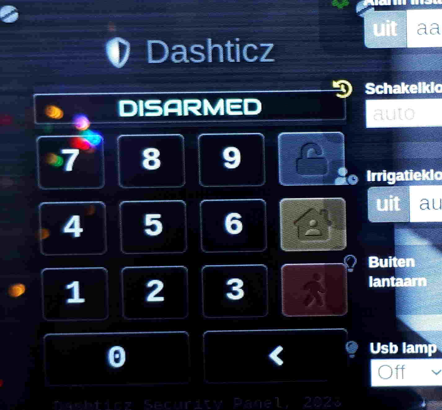

Jablotron connection, Ikea
pvklink
Posts: 822
Joined: Wednesday 12 November 2014 15:01
Domoticz version: latest b
Re: Dashticz v3.7.2 beta (read update instructions!!)
Post by pvklink »
ok, i used your script.
I changed the first line in cd /home/pi thats where my dashticz folder is...
And then runned the script...
everything went OK.
can i use your script as a future standard for updating beta dashticz or is this script only useful for this situatation ?
I will check my two configuartions
- one for my desktop (custom)
- one for my wall tablet
Only thing i can see this far is that my security panel has become greater and has an overlap with my other buttons (that are on the right of the panel
i use these setting in my css file
/* security panel */
/* div[data-id='secpanel'] {background-color: rgba(87, 64, 56, 1) !important; } dit is het block achter het zwarte secpanel, als je dit weglaat is het bruine block niet zichtbaar wel nodig als je eronder blokken wil tonen */
[data-id='secpanel'] .dt_content {height: 360px!important; width: 260px!important; }
div[data-id='secpanel'] {height: 400px !important;width: 340px!important;}
Lokonli
Posts: 2292
Post by Lokonli »
pvklink wrote: Tuesday 29 December 2020 11:37 ok, i used your script.
everything went OK.
The script is only needed in case something is messed up.
Normally you only have to do 'git pull'. This will always be risk free: git pull will not overwrite files you've changed.
In 3.7.2 there are indeed some changes in the css styling of the security panel.
I would expect there is no need anymore to set the height/width manually in custom.css. You can remove both lines from custom.css.
The security panel automatically scales to the width of the column. If it's too wide, set the block parameter 'scale ' to for instance 0.8 to scale it to 80% of the column width.
pvklink
Posts: 822
Post by pvklink »
ok, clear!
I also tried:
blocks['secpanel'] = {width: 12, headerText: 'test',footerText: 'test2'}
This works ok on my desktop with custom folder settings on safari
When i use this in custom_2 folder for my rpi with small touchschreen and default buster browser it does not show the headerText and footerText ( shows the default)...
Lokonli
Posts: 2292
Post by Lokonli »
pvklink wrote: Tuesday 29 December 2020 13:19 ok, clear!
I also tried:
Probably a caching issue. I fixed this in index.html, but forgot to update index2.html.
I already made a change to beta.
Can you update to the latest version?
Just do a 'git pull' :)
pvklink
Posts: 822
Post by pvklink »
i will..
pvklink
Posts: 822
Post by pvklink »
And it works !!!
Do i have to test more securitypanel stuff ?
Lokonli
Posts: 2292
Post by Lokonli »
pvklink wrote: Tuesday 29 December 2020 14:19 And it works !!!
Can you test with decorate:false and your pi screen?
pvklink
Posts: 822
Post by pvklink »
Works!
