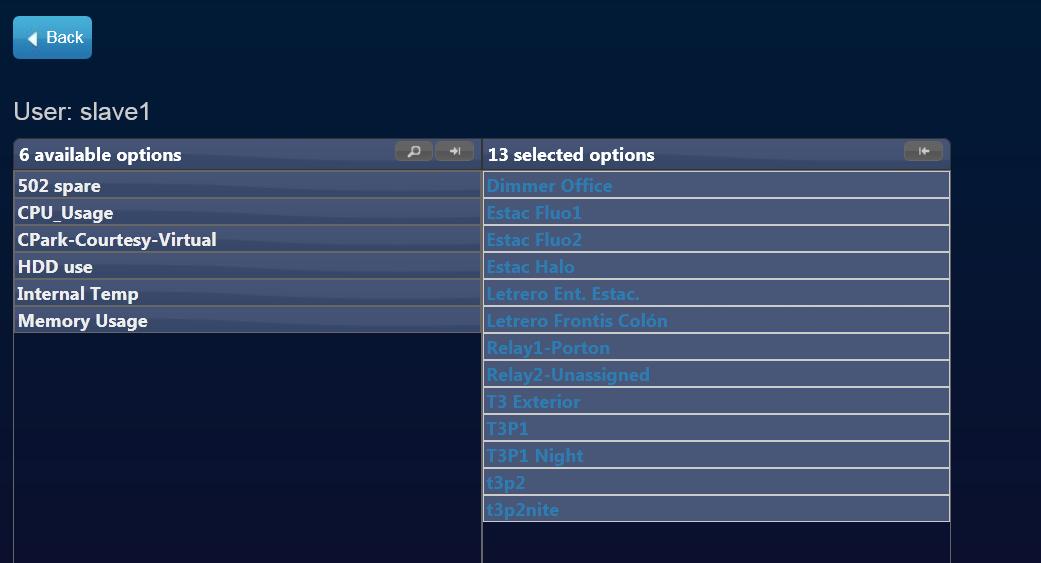

I found Item 15 on that list is a little unclear.
You may have done this already, but on the Remote unit:
Settings->More Options->Edit Users
Top RHS blue button Set Devices

Strange. Maybe its obvious but....
Screenshot_2020-12-26 Domoticz.png (9.18 KiB) Viewed 5505 times
