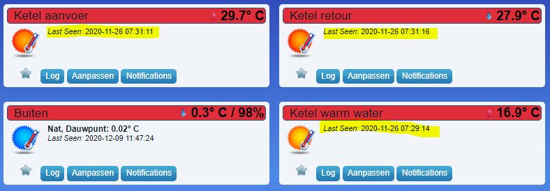

My Fibaro FGBS-001 sensor has been working perfectly for years, but a few weeks ago the three one-wire sensors lost connection to Domoticz.
On the temperature tab you van see they last connected at 26-11-2020:
Sensors Domoticz.JPG (51.21 KiB) Viewed 584 times

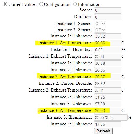

While looking at the OpenZwave control panel you can see that the temperature sensors are working and are showing the right temperatures:
OZW Control panel.JPG (52.01 KiB) Viewed 584 times
So, i think the sensor is fine but the Z-Wave stick is not corresponding the temperatures to the Domoticz dashboard.
