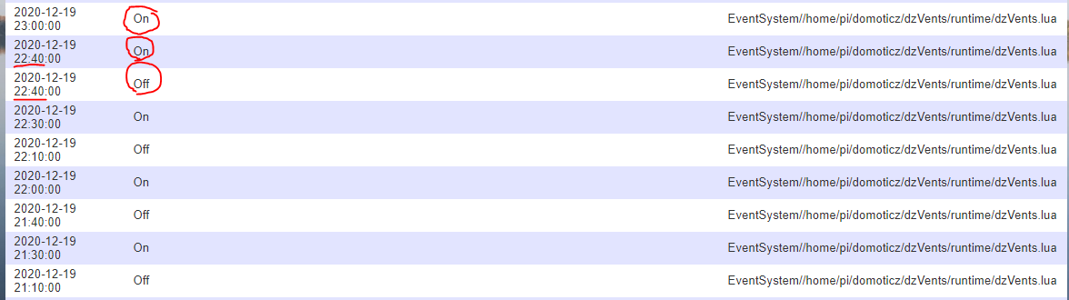

I have been puzzled what causes a strange behavior with .forMin() function. I have a very simple script to keep a device on for 10 minutes, then off for 20 minutes:
		timer = {
			'Every 30 minutes',
	execute = function(dz)
		dz.devices('Device').switchOn().forMin(10)
It works for a day or two fine, but then at some point it never switches off again. In the log you can see something like this:
So there is the on/off action going on fine but then at some seemingly random point in time the off action is followed by an immeadiate on, and another on after 20 minutes but then nothing. I know I can (and will) write the script in a different way to make sure off swithchin happens reliably, I was just wondering what is causing this behavior...

Thanks, I ran into this at some point with my PIR controlled lights at home, but then I was able to see the logic behind it as there were commands coming for the lights from other sources than the PIR script. However, in this case it is only this script that is controlling the device and also in the logs one can see that all commands for the device are issued by the script. So, indeed the second "on" explains why the switch never goes off after this, as it at that point returns it to the "on" state. So it is not a very robust way of trying to automate this, I admit. But still I am left wondering what causes the second "on" command at that (random) time. Does the "every 30 minutes" somehow reset to and start counting again or something like that...
