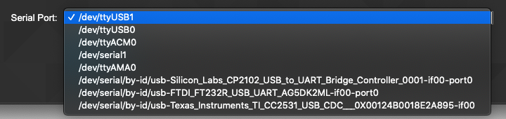

I recently got hold of an old zwave stick (aeotec series 2 black), and a zigbee sniffer, and I'm using p1 meter on usb too. How do i figure out what usb-port-name to use in domoticz to get the correct device talking to the correct hardware?
I found the p1 on ttyUSB1 (because the domoticz device updates correctly)
i think the zigbee stick is on /dev/ttyACM0 (at least, that is the zigbee2mqtt default. And it seems to work right now.
But this aeotect doesn't really identify itself. and i don't know what to look for. lsusb doesnt show anything recognizable. In Domoticz there is a ttyUSB1 and there is a ttyAMA0. There are a few others as well with very long names like: /dev/serial/by-id/usb-FTDI_FT232R_USB_UART_AG5DK2ML-if00-port0. In fact, when i connect the hardware in domoticz to any of those, it first tells me the manager is down. (cool. i don't like managers :/ ). and after a while it tells me openzwave version and gives me a setup button. does that mean it works? on any of those three ports? Or do i need another port? Any of these:
Screenshot 2020-12-19 at 21.38.02.png (123.4 KiB) Viewed 912 times
Do i need to do anything specific in that setup screen? this is all pretty hazy and unclear tbh... And the domoticz wiki page is very descriptive, but not very helpful as a step by step howto...

Re: what usb device is my zwave stick?
wkossen wrote: Saturday 19 December 2020 21:47 any pointers to useful documentation would be much appreciated.
Check this wiki page

thanks. that helped. now i could determine the aeotec is ttyUSB0.
also good to know that i can somehow force usb devices to be persistent. need to tinker a bit with that. i plan to add an usb hub to the pi as these sticks dont really fit well as it is. especially the aeotec, it blocks one of the usbs that i want the rfxcom to go on when it arrives. and when i plug these things into a hub, i bet they are going to get switched around again. sigh....
so the aeotec now works and it shows me a set of devices that apparently the previous owner of the stick had... weird. need to figure out how to remove those....
