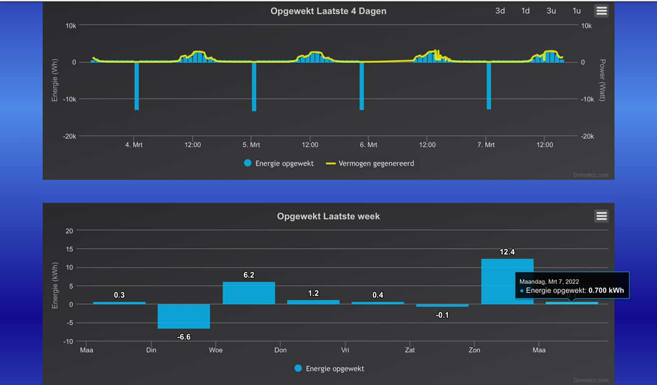

The Lua script from Raymond has worked flawlessly until some weeks ago. Some days showed a negative revenue of my solarpanels where the data from Semsportal is ok. I added some pictures.
Anyone knows what goes wrong in my situation?
