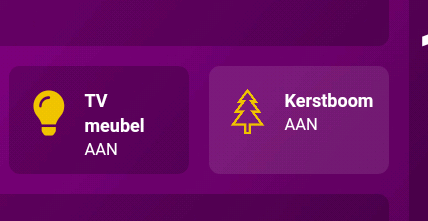

Yes, I experience the same here. This has been an issue before but was fixed than. I searched, but could't find the post. But now it’s back, since a couple of months al least I think. Not in the browsers on a Windows machine though, but on a tablet the background of the touched button stays lighter. Using Fully Kiosk on the tablet.
Button touch.png (25.78 KiB) Viewed 1203 times

Yes, this is exactly the same, also with my christmastree :-)
