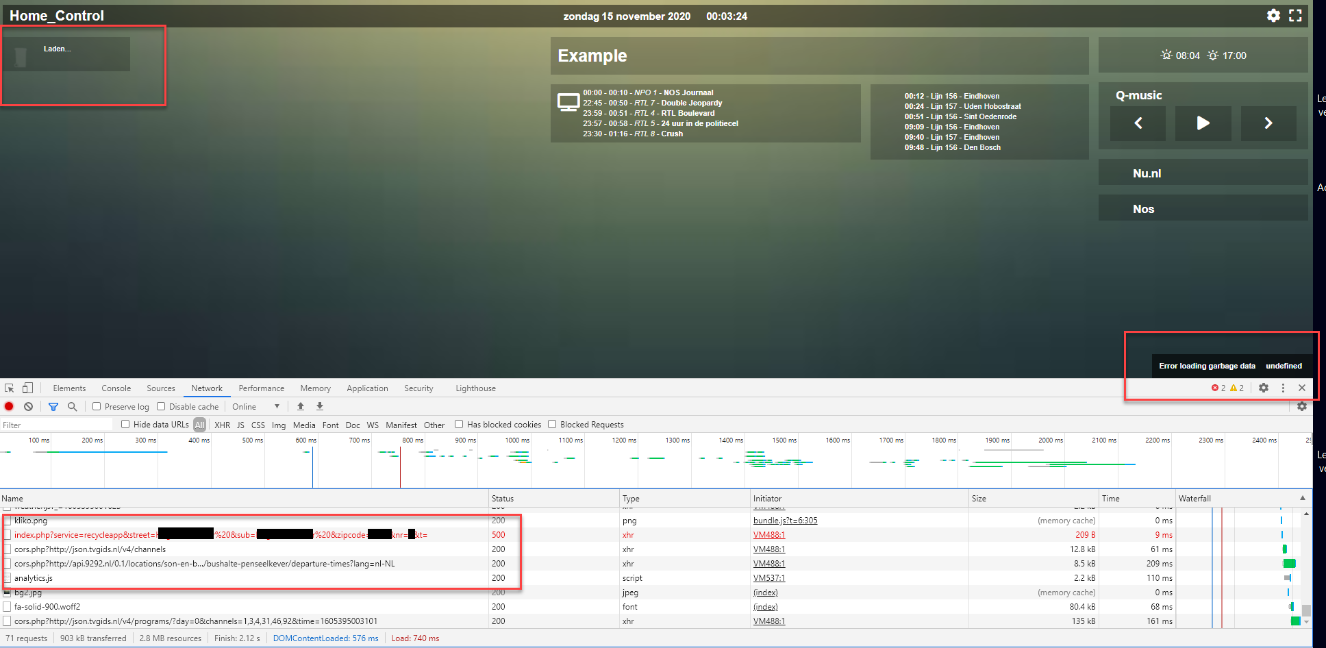

Gianni
Posts: 230
Joined: Saturday 21 July 2018 19:03
Location: Home@Belgium
Re: Dashticz - Module - Garbage collector
Post by Gianni »
Still getting the garbage not working.
server information
gianni@webserver:/$ lsb_release -a
No LSB modules are available.
Distributor ID: Ubuntu
Description: Ubuntu 20.04 LTS
Release: 20.04
Codename: focal
gianni@webserver:/$ apache2 -v
Server version: Apache/2.4.41 (Ubuntu)
Server built: 2020-08-12T19:46:17
gianni@webserver:/$ php -v
PHP 7.4.3 (cli) (built: Oct 6 2020 15:47:56) ( NTS )
Copyright (c) The PHP Group
Zend Engine v3.4.0, Copyright (c) Zend Technologies
with Zend OPcache v7.4.3, Copyright (c), by Zend Technologies
Dashticz info (manual installation,don't like docker)
Config.js
config['static_weathericons'] = 0;
config['hide_mediaplayer'] = 0;
config['garbage_company'] = 'recycleapp';
config['garbage_icalurl'] = '';
config['google_api_key'] = '';
config['garbage_calendar_id'] = '0';
config['garbage_zipcode'] = '********';
config['garbage_street'] = '********* ';
config['garbage_housenumber'] = '****';
config['garbage_housenumberadd'] = '';
config['garbage_maxitems'] = '5';
config['garbage_width'] = '3';
config['garbage_icon_use_colors'] = 1;
config['garbage_use_colors'] = 1;
config['garbage_use_names'] = 1;
config['garbage_use_cors_prefix'] = 1;
config['garbage_mapping'] = {
rest: ['sortibak'],
gft: ['biobak'],
papier: ['papier', 'karton'],
config['garbage'] = {
gft: {kliko: 'green', code: '#375b23', name: 'GFT', icon: 'img/garbage/kliko_green.png'},
rest: {kliko: 'grey', code: '#5e5d5c', name: 'Restafval', icon: 'img/garbage/kliko_grey.png'},
papier: {kliko: 'blue', code: '#153477', name: 'Papier', icon: 'img/garbage/kliko_blue.png'},
link adres
http://10.10.20.6/domo/vendor/dashticz/ ... *******&t=
request headers
GET /domo/vendor/dashticz/garbage/index.php?service=recycleapp&street=**********%20&sub=*****************%20&zipcode=*******&nr=***&t= HTTP/1.1
Host: 10.10.20.6
Connection: keep-alive
Accept: application/json, text/javascript, */*; q=0.01
User-Agent: Mozilla/5.0 (Windows NT 10.0; Win64; x64) AppleWebKit/537.36 (KHTML, like Gecko) Chrome/86.0.4240.183 Safari/537.36
X-Requested-With: XMLHttpRequest
Referer: http://10.10.20.6/domo/
Accept-Encoding: gzip, deflate
Accept-Language: en-US,en;q=0.9
response header
HTTP/1.0 500 Internal Server Error
Date: Sat, 14 Nov 2020 23:22:12 GMT
Server: Apache/2.4.41 (Ubuntu)
Access-Control-Allow-Origin: *
Content-Length: 0
Connection: close
Content-Type: application/json
error in webpage
Its looks like the cors is not working for the garbage but it's works for the bus and tv gids.
If you need more information just ask :-)

it looks like only the garbage does not use the cors proxy
extra info but i dont know if this is relevant.
i use 2 servers.
domotic run on server1 (fictief name)
dashticz on server2 (fictief name)
acces log
10.10.20.243 - - [15/Nov/2020:08:53:11 +0000] "GET /domo/vendor/dashticz/garbage/index.php?service=recycleapp&street=**********r&sub=**********r&zipcode=*********&nr=******&t= HTTP/1.1" 500 209 "http://10.10.20.6/domo/" "Mozilla/5.0 (Windows NT 10.0; Win64; x64) AppleWebKit/537.36 (KHTML, like Gecko) Chrome/86.0.4240.183 Safari/537.36"
10.10.20.243 - - [15/Nov/2020:08:53:11 +0000] "GET /domo/vendor/dashticz/cors.php?http://json.tvgids.nl/v4/channels HTTP/1.1" 200 12784 "http://10.10.20.6/domo/" "Mozilla/5.0 (Windows NT 10.0; Win64; x64) AppleWebKit/537.36 (KHTML, like Gecko) Chrome/86.0.4240.183 Safari/537.36"
10.10.20.243 - - [15/Nov/2020:08:53:11 +0000] "GET /domo/vendor/dashticz/cors.php?http://api.9292.nl/0.1/locations/son-en ... lang=nl-NL HTTP/1.1" 200 8517 "http://10.10.20.6/domo/" "Mozilla/5.0 (Windows NT 10.0; Win64; x64) AppleWebKit/537.36 (KHTML, like Gecko) Chrome/86.0.4240.183 Safari/537.36"
10.10.20.243 - - [15/Nov/2020:08:53:11 +0000] "GET /domo/dist/assets/fonts/fa-solid-900.woff2 HTTP/1.1" 200 80437 "http://10.10.20.6/domo/" "Mozilla/5.0 (Windows NT 10.0; Win64; x64) AppleWebKit/537.36 (KHTML, like Gecko) Chrome/86.0.4240.183 Safari/537.36"
10.10.20.243 - - [15/Nov/2020:08:53:11 +0000] "GET /domo/vendor/dashticz/cors.php?http://json.tvgids.nl/v4/programs/?day= ... 5430389921 HTTP/1.1" 200 123593 "http://10.10.20.6/domo/" "Mozilla/5.0 (Windows NT 10.0; Win64; x64) AppleWebKit/537.36 (KHTML, like Gecko) Chrome/86.0.4240.183 Safari/537.36"
10.10.20.243 - - [15/Nov/2020:08:54:11 +0000] "GET /domo/vendor/dashticz/cors.php?http://api.9292.nl/0.1/locations/son-en ... lang=nl-NL HTTP/1.1" 200 8518 "http://10.10.20.6/domo/" "Mozilla/5.0 (Windows NT 10.0; Win64; x64) AppleWebKit/537.36 (KHTML, like Gecko) Chrome/86.0.4240.183 Safari/537.36"
error log
[Sun Nov 15 08:53:11.354378 2020] [php7:error] [pid 319869] [client 10.10.20.243:6861] PHP Fatal error: Uncaught Error: Call to undefined function curl_init() in /var/www/web/domo/vendor/dashticz/garbage/index.php:284\nStack trace:\n#0 {main}\n thrown in /var/www/web/domo/vendor/dashticz/garbage/index.php on line 284, referer: http://10.10.20.6/domo/
did some testsingthat maybe can help
when i refresh my browser i notice this url.
h**p://10.10.20.6/domo/vendor/dashticz/garbage/index.php?service=recycleapp&street=********&sub=********&zipcode=*****&nr=**&t=
is see that it's use index.php and no cors.php
"GET /domo/vendor/dashticz/garbage/index.php?service=recycleapp&street=***********&sub=***********&zipcode=******&nr=***&t=
so i test it with this url myself in the browser and change index.php to cors.php
h**p://10.10.20.6/domo/vendor/dashticz/garbage/cors.php?service=recycleapp&amp;street=*********&amp;sub=**********&amp;zipcode=*************&amp;nr=*****&amp;t=
i see this in my error log
[Sun Nov 15 09:22:45.167075 2020] [php7:error] [pid 320339] [client 10.10.20.243:10190] script '/var/www/web/domo/vendor/dashticz/garbage/cors.php' not found or unable to stat
indeed there is no cors.php in my garbage folder
So i copied the cors from dashticz to garbage
then i run the url again
i get a 200 on my get but no response (so far my knowledge of post and get)
Request URL: http://10.10.20.6/domo/vendor/dashticz/ ... ***&amp;t=
Request Method: GET
Status Code: 200 OK
Remote Address: 10.10.20.6:80
Referrer Policy: strict-origin-when-cross-origin
Cache-Control: no-store, no-cache, must-revalidate, max-age=0
Cache-Control: post-check=0, pre-check=0
Connection: Keep-Alive
Content-Length: 0
Content-Type: text/html; charset=UTF-8
Date: Sun, 15 Nov 2020 09:26:00 GMT
Keep-Alive: timeout=5, max=100
Pragma: no-cache
Accept: text/html,application/xhtml+xml,application/xml;q=0.9,image/avif,image/webp,image/apng,*/*;q=0.8,application/signed-exchange;v=b3;q=0.9
Cache-Control: max-age=0
Host: 10.10.20.6
Upgrade-Insecure-Requests: 1
service: recycleapp
amp;street: *******
amp;sub: ********
amp;zipcode: *******
amp;nr: *
amp;t:
is see this error in my error.log
[Sun Nov 15 09:31:30.283779 2020] [php7:warn] [pid 305762] [client 10.10.20.243:11125] PHP Warning: file_get_contents(service=recycleapp&amp;amp;street=********&amp;amp;sub=******&amp;amp;zipcode=******&amp;amp;nr=*****&amp;amp;t=): failed to open stream: No such file or directory in /var/www/web/domo/vendor/dashticz/garbage/cors.php on line 28
[Sun Nov 15 09:31:30.283862 2020] [php7:notice] [pid 305762] [client 10.10.20.243:11125] PHP Notice: Undefined variable: http_response_header in /var/www/web/domo/vendor/dashticz/garbage/cors.php on line 29
[Sun Nov 15 09:31:30.283875 2020] [php7:warn] [pid 305762] [client 10.10.20.243:11125] PHP Warning: Invalid argument supplied for foreach() in /var/www/web/domo/vendor/dashticz/garbage/cors.php on line 5
may this will help

Request Method: GET
Status Code: 200 OK
Content-Length: 0
Pragma: no-cache
Host: 10.10.20.6
service: recycleapp
amp;street: *******
amp;sub: ********
amp;nr: *
amp;t:
may this will help
From the error log you can see that php curl is not installed.
Try the following:
sudo apt-get update
sudo apt-get install php-xml php-curl libapache2-mod-php
sudo systemctl restart apache2
And then retry again without your changes (cors.php is not needed in the garbage folder!)

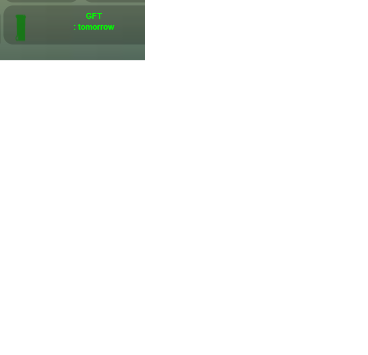

I did some styling myself but can't figure out the following.
1. I would like to have the garbage icon to be the same color as my text. (the darker green is unreadable).
2. I put a break line between the name and the date but I cannot remove the colon before the date. is there a quick fix for that?
thanx in advance!
Jacco
Enz0jacco
Posts: 45
Joined: Tuesday 03 March 2020 8:15
Post by Enz0jacco »
okay number 1 is fixed by just inserting a new image in the img/garbage folder with the new color.
still looking to get rid of the colon:P
