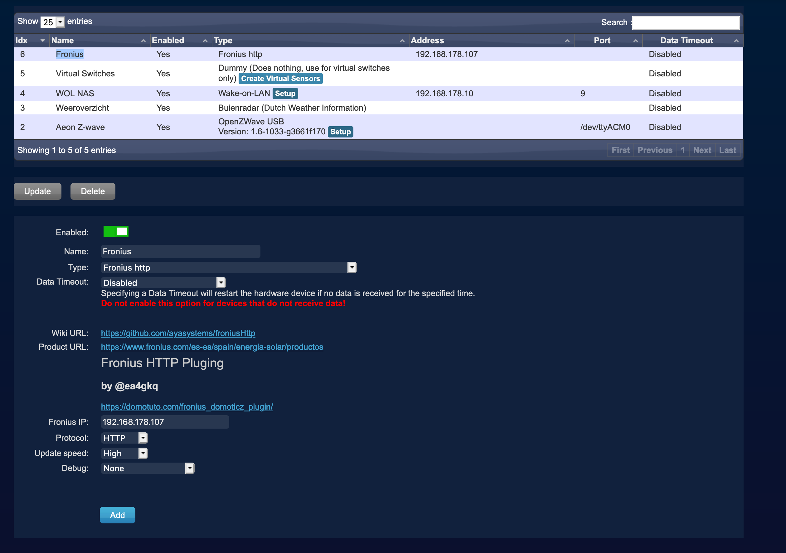

I have completed another plugin to integrate Fronius FV inverter into domoticz
https://github.com/ayasystems/froniusHttp
Enjoy it!

zettie wrote: Tuesday 07 July 2020 10:11 Hi,
I followed your instructions to install it on my raspberry ( https://domotuto.com/fronius_domoticz_plugin/ ), but i don't see any values in the information fields. When I go to the Fronius converter on my local network I do see the values
Are there some more settings, for instance on the Fronius converter?
Did you provide the relevant settings??
Host IP ....
Please send a screen shot

Yes, I,ve filled in the IP adress.
