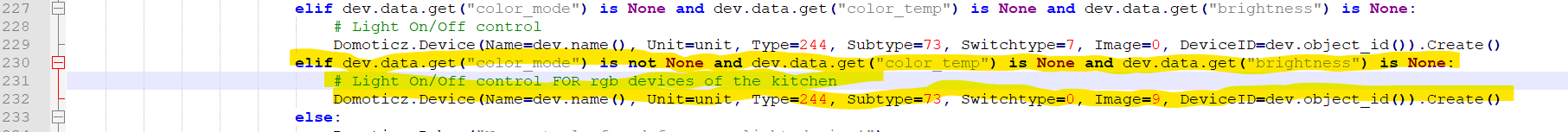

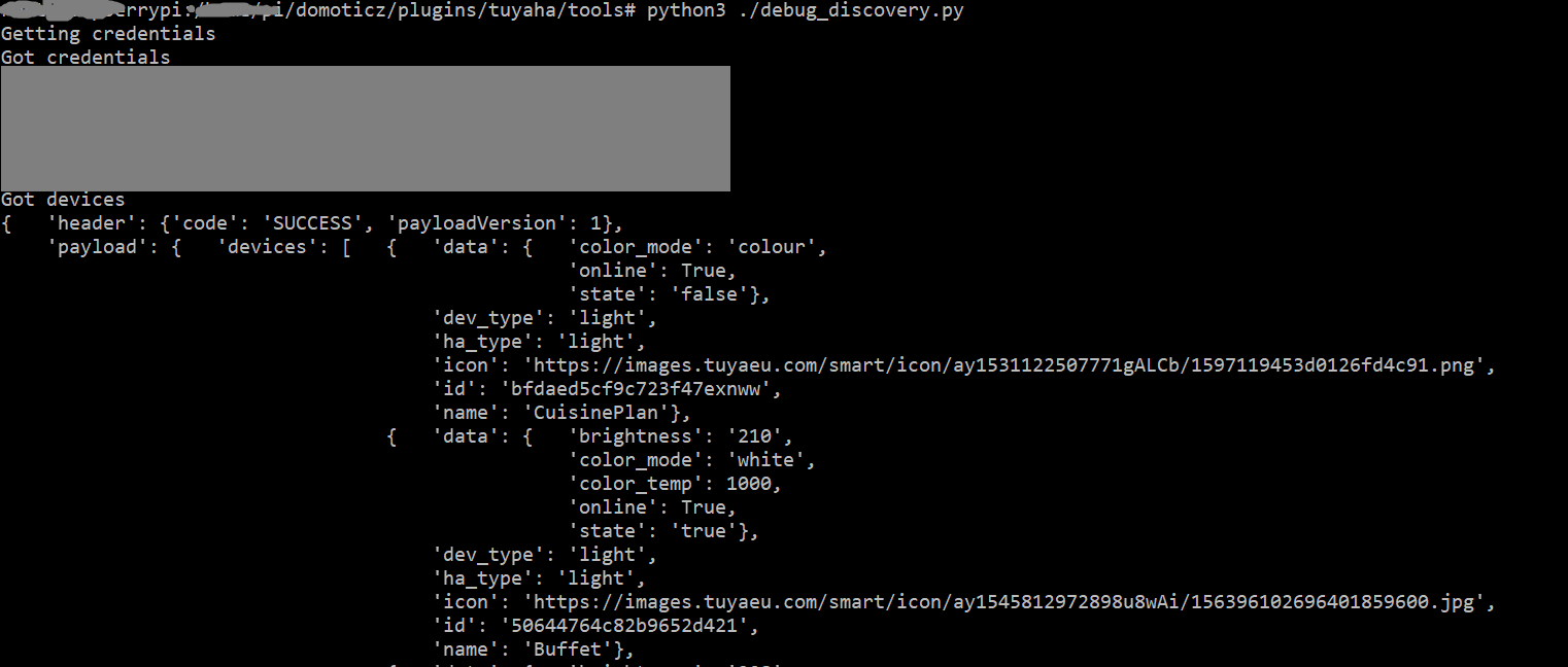

Xenomes
following the post in Re: Python Plugin still running after disabling in Hardware page @ viewtopic.php?f=65&t=34563
I do these modifications because I bought 2 RGB led strip controllers (CuisinePlan is one of them) and there is a mode colour but no brightness neither no color_temp, so I use them as switch even it could use them at least as dimmer :-(

That is strange, if you change setting in the used Tuya-App and rerun the debug_discovery.py script do you get other data fields in the JSON?

                                      'id': 'ADJthuwyxX3',
                                      'name': 'Si Chassieu Lever Ouvrir ami / '
                                              'Salon'}],
                   'scenes': []}}

cle69 wrote: Monday 30 November 2020 16:21 You can find below the discovery log
the faulty device is "Volet Salon 1"
The strange thing is the 'tuyaha' report it as a switch. can you change the state of the device and run the debug_discovery.py again?
HP T630 (256GB SSD/8GB Mem) - Ubuntu 24.04.4 LTS (64Bit) - Domoticz 2026.4 (Docker)

cle69 wrote: Monday 30 November 2020 16:21 The strange thing is the 'tuyaha' report it as a switch. can you change the state of the device and run the debug_discovery.py again?
Yes that is strange, I have tested to open and close and the status never change, it is always State = False. :(
With Smart Life application is work well, with some new options, percentage, child lock...
I'm wondering if it's not using a new, improved API version :?:
