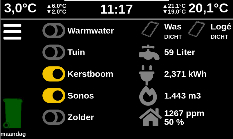

Hello everyone,
For everyone who also displays Dashticz on a 7 inch touchscreen, here's a preview of my project.
I have enlarged all blocks and texts, so that it can also be read from a distance.
>>Raspberry Pi 4<<>>Raspberry Pi 3 + 7-inch Touchscreen<<>>Ikea Tradfri<<>>Nefit Easy<<>>ESP-Easy<<>>Netatmo<<>>Sonos<<
CONFIG.js

  title: '',
  icon : '',  //laagste temperatuur buiten >24h
  //image : '',
  switch : true,
  hide_title : 1,
  hide_data : 1,
  protected: 1,
  last_update : false,
blocks[239] = {
  width: 1,
  //title: '',
  icon : '',  //hoogste temperatuur buiten >24h
  //image : '',
  switch : true,
  hide_title : 1,
  hide_data : 1,
  protected: 1,
blocks[198] = {
  width: 12,
  title: '',
  imageOn : 'Wasmachine.png',  //Wasmachine
  iconOff : '',
  switch : 0,
  hide_title : 1,
  hide_data : 1,
  protected: 1,
  last_update : 0,
  //gotoslideOn: 5,
blocks[184] = {
  width: 12,
  title: '',
  imageOn : 'dishwasher_240px.png',  //Vaatwasser
  //imageOn : 'washer1.svg',  //Vaatwasser
  iconOff : '',
  switch : 0,
  hide_title : 1,
  hide_data : 1,
  protected: 1,
  last_update : 0,
  //gotoslideOn: 5,
blocks[234] = {
  width: 12,                //Luchtkwaliteit Woonkamer
  //title: '',
  //iconOff : '',
  icon : 'fas fa-home',
  switch : 1,
  hide_title : 1,
  //hide_data : 1,
  //protected: 1,
  last_update : 0,
  //gotoslideOn: 5,
blocks[235] = {
  width: 12,                //ppm/% Woonkamer
  //title: '',
  //iconOff : '',
  //switch : 1,
  //hide_title : 1,
  //hide_data : 1,
  //protected: 1,
  last_update : 0,
  //gotoslideOn: 5,
blocks['164_1'] = {
  width: 12,
  icon : 'fas fa-fire-alt',  //Gasverbruik
  switch : 1,
  hide_title : 1,
  hide_data : 1,
  protected: 1,
  last_update : 0,
  popup: 'popup_gas'
blocks['popup_gas'] = {
   title: 'Gasverbruik vandaag',
   devices: [164],
   toolTipStyle: false,
   //datasetColors: ['red', 'yellow'],
   graph: 'bar',
custom : {
        "laatste uren": {
            range: 'day',
            filter: '4 hours',
            data: {
                m3: 'd.v_164*0.1'            }
  "vandaag": {
            range: 'day',
            filter: '12 hours',
            data: {
               m3: 'd.v_164*0.1'            }
  "afgelopen maand": {
            range: 'month',
            //filter: '7 days',
            data: {
                m3: 'd.v_164'            }
blocks['160_2'] = {
  width: 12,
  icon : 'fas fa-plug',  //Stroomverbruik
  switch : 1,
  hide_title : 1,
  hide_data : 1,
  protected: 1,
  last_update : 0,
  popup: 'popup_stroom'
blocks['popup_stroom'] = {
   title: 'Stroomverbruik vandaag',
   devices: [160],
   graph: 'bar',
custom : {
        "laatste uren": {
            range: 'day',
            filter: '4 hours',
            data: {
                watt: 'd.v_160*1+d.v2_160*1'            }
  "vandaag": {
            range: 'day',
            filter: '12 hours',
            data: {
            range: 'month',
            //filter: '7 days',
            data: {
                kWh: 'd.v_160*1+d.v2_160*1'            }
blocks['42_1'] = {
  width: 12,
  icon : 'fas fa-faucet',  //Waterverbruik
  switch : 1,
  hide_title : 1,
  hide_data : 1,
  protected: 1,
  last_update : 0,
  popup: 'popup_water'
blocks['popup_water'] = {
   title: 'Waterverbruik vandaag',
   devices: [42],
   graph: 'bar',
custom : {
        "laatste uren": {
            range: 'day',
            filter: '4 hours',
            data: {
                liter: 'd.v_42*100'            }
  "vandaag": {
            range: 'day',
            filter: '12 hours',
            data: {
            range: 'month',
            //filter: '7 days',
            data: {
                liter: 'd.v_42*1000'            }
blocks['dial_zolder'] = {
        idx: 232,
        title: 'Was Zolder',
        type: 'dial',
        setpoint: 60,
        min: 40,
        max: 80,
        width: 4,
        shownumbers: true,
        last_update: false,
values: [
                        value:'Humidity',
                        unit:' %',
                        value:'Temp',
                        unit:' °C',
blocks['dial_badkamer'] = {
        idx: 183,
        title: 'Badkamer',
        type: 'dial',
        setpoint: 60,
        min: 40,
        max: 80,
        width: 4,
        shownumbers: true,
        last_update: false,
values: [
                        value:'Humidity',
                        unit:' %',
                        value:'Temp',
                        unit:' °C',
blocks['dial_netatmo'] = {
        idx: 234,
        title: 'Woonkamer',
        type: 'dial',
        setpoint: 60,
        min: 40,
        max: 80,
        width: 4,
        shownumbers: true,
        last_update: false,
values: [
                        value:'Humidity',
                        unit:' %',
                        value:'Temp',
                        unit:' °C',
blocks['nefiteasy'] = {
        idx: 230,
        title: 'Nefit Easy',
        type: 'dial',
        width: 4,
blocks['sonos_controller'] = {
        idx: 237,
        title: 'Sonos Radio',
        type: 'dial',
        width: 6,
blocks['sonos_volume'] = {
        idx: 39,
        title: 'Sonos Volume',
        type: 'dial',
        shownumbers: true,
        min: 0,
        max: 25,
   	width: 6,
blocks['blocktitle_1'] = {
  type: 'blocktitle',
  //title: 'Schakelaars',
  width: 12
blocks['blocktitle_2'] = {
  type: 'blocktitle',
  //title: 'Menu',
  width: 12
blocks['blocktitle_3'] = {
  type: 'blocktitle',
  //title: 'Info',
  width: 12
var buttons = {}
buttons.p2 = {key: "button0",width:2, isimage:true, icon:'fas fa-bars',  title: '', slide:2}
buttons.p1 = {key: "button1",width:2, isimage:true, icon:'fas fa-reply',  title: '', slide:1}
buttons.p3 = {key: "button2",width:2, isimage:true, icon:'fas fa-music',  title: '', slide:3}
buttons.p4 = {key: "button3",width:2, isimage:true, icon:'fas fa-info',  title: '', slide:2}
var columns = {}
columns['bar0'] = {}
columns['bar0']['blocks'] = [79,239,238,'miniclock',206,211,72]
columns['bar1'] = {}
columns['bar1']['blocks'] = [buttons.p1]
columns[1] = {
  blocks:  ['blocktitle_1',75,33,227,'s1','s3'],
  width: 5
columns[2] = {
  blocks:  ['blocktitle_3',56,57,'42_1','160_2','164_1',235],
  width: 5
columns[3] = {
  blocks:  ['dial_netatmo','dial_badkamer','dial_zolder'],
  width: 10
columns[4] = {
  blocks:  ['sonos_controller','sonos_volume'],
  width: 10
columns['menu0'] = {
  blocks:  ['blocktitle_2',buttons.p2,184,198,'garbage'],
  width: 2
columns['menu1'] = {
  blocks:  [buttons.p1,buttons.p4,buttons.p3],
  width: 1
columns[5] = {
  width: 1
columns['menu2'] = {
  blocks:  [buttons.p2],
  width: 1
var screens = {}
screens[1] = {
  columns: ['bar0','menu0',1,2],
  background: 'bg0.jpg',
screens[2] = {
  columns: ['menu1', 3],
screens[3] = {
  columns: ['menu1', 4],
custom.css
CUSTOM CSS FILE
.transbg.col-xs-1,.transbg.col-xs-2,.transbg.col-xs-3,.transbg.col-xs-4,.transbg.col-xs-5,.transbg.col-xs-6,.transbg.col-xs-7,.transbg.col-xs-8,.transbg.col-xs-9,.transbg.col-xs-10,.transbg.col-xs-11,.transbg.col-xs-12 {
	padding-top:0px;
	padding-bottom:15px;
	border: 1px solid rgba(255,255,255,0);		/* border: 7px -> 3px - Smaller space between blocks */
	background: rgba(0,0,0,1.0);
	background-clip: padding-box;
	border-radius: 0px;						/* Round corners */
.transbg.dark.col-xs-1, .transbg.dark.col-xs-2, .transbg.dark.col-xs-3, .transbg.dark.col-xs-4, .transbg.dark.col-xs-5, .transbg.dark.col-xs-6, .transbg.dark.col-xs-7, .transbg.dark.col-xs-8, .transbg.dark.col-xs-9, .transbg.dark.col-xs-10, .transbg.dark.col-xs-11, .transbg.dark.col-xs-12 {
    border: 1x solid rgba(255,255,255,0);
    height: 50px !important;
    //border-bottom: 4px solid #fff !important;
    //border-radius: 50px;
.col-data .title {font-size:30px; margin-left: 60px;}
.col-data .state {font-size:24px; margin-left: 60px;}
.col-data .value {font-size:30px; margin-left: 60px; font-weight: bold; position: absolute; bottom: -30px !important;}
.col-data .lastupdate {font-size:24px; margin-left: 60px;}
.far,.fas,.wi,.fab{
   font-size:70px !important;
.blocktitle {
    background: grey !important;
    height: 1px !important;
.block_27 .on {
  color:#F1C300;
.block_27 .off {
  color:#fff;
.block_33 .on {
  color:#F1C300;
.block_33 .off {
  color:#fff;
.block_33 .title {
  position: absolute;
  bottom: -55px !important;
.block_56 {
  max-width: 160px;
.block_56 .state {
  font-size: 20px !important;
  font-weight: bold;
.block_56 img.icon {
	max-width: 200px !important
.block_57 {
  max-width: 160px;
.block_57 .state {
  font-weight: bold;
.block_57 img.icon {
.block_72 {
  height: 0px !important;
  margin-left: -110px;
  background-color: rgba(0,0,0,0) !important;
  bottom: 5px !important;
.block_72 .title {
  font-size: 45px !important;
.block_79 {
  margin-left: -85px;
.block_79 .title {
.block_75 .on {
  color:#F1C300;
.block_75 .off {
  color:#fff;
.block_75 .title {
  position: absolute;
.block_206 {
  margin-left: -200px;
  bottom: -25px !important;
.block_206 .title {
  //color: blue;
.block_211 {
  bottom: -5px !important;
.block_211 .title {
  //color: red;
.block_238 {
  margin-left: -67px;
.block_238 .title {
  //color: blue;
.block_239 {
  margin-left: 60px;
.block_239 .title {
  //color: red;
.block_227 .on {
  color:#F1C300;
.block_227 .off {
  color:#fff;
.block_227 .title {
  position: absolute;
.block_235 img.icon {
  max-width: 100px !important;
.block_s1 .on {
  color:#F1C300;
.block_s1 .off {
  color:#fff;
.block_s1 .title {
  position: absolute;
.block_s3 .on {
  color:#F1C300;
.block_s3 .off {
  color:#fff;
.block_s3 .title {
  position: absolute;
.block_184 {
  height: 95px !important;
.block_184 img.icon {
  margin-left: -15px;
.block_198 {
.block_198 img.icon {
  max-width: 80px !important;
  margin-left: -5px;
.block_42_1 .title {
  position: absolute;
.block_160_2 .title {
  position: absolute;
.block_164_1 .title {
  position: absolute;
/* Weersvoorspelling  */
.block_currentweather_big_owm {
  height: 80px !important;
  bottom: 10px !important;
 .block_currentweather_big_owm .skycon {
  max-width: 100px;
  width: 140px;
  margin-left: -30px;
 .block_currentweather_big_owm .title {
  font-size: 42pt;
  margin-left: 40px;
 .block_currentweather_big_owm .weatherloc {
  font-size: 14pt;
/* Afvalkalender Rova  */
 .dt_state .trashrow {
    font-size: 20px;
    font-weight: bold;
    position: absolute;
    //bottom: -95px !important;
    margin-left: -18px;
 .dt_state .trashtoday {
    font-size: 20px;
    font-weight: bold;
    position: absolute;
    margin-left: -18px;
 .dt_state .trashtomorrow {
    font-size: 20px;
    font-weight: bold;
    position: absolute;
    margin-left: -18px;
.trashcan {
    height: 110px;
    width: 110px;
    max-width: 150px !important;
    margin-left: -25px;
.block_garbage {
  width: 220px !important;
  height: 100px !important;
  margin-left: -20px;
  bottom: 0px !important;
/* Miniklok  */
.colbar.transbg .miniclock span{
  font-size:0px !important;
  font-weight:bold !important;
  margin-left: 0px;
.colbar.transbg {
    padding-left: 200px !important;
    padding-right: 0px !important;
    padding-top: 2px !important;
    padding-bottom: 2px !important;
.miniclock span{
  font-size:45px !important;
  margin-left: -10px;
/* Miniklok  */
/* Alle Grafieken   */
.graphbuttons .fas {
    display:none
.graphtitle .fas {
    display: none
.graphheight {
  height: 900px;
  max-height: 1000px !important;
.graphwidth {
  width: 780px;
/* Tekstkleuren  */
.textred {	color: red !important;}
.textorange {	color: orange !important;}
.textgreen {	color: green !important;}
.warningblue {    color: green !important;  }
/* Tekstkleuren  */
.swiper-pagination-bullet {
    display: none !important
/* Iconkleuren  */
.fas.fa-fire-alt {
   color: grey !important;
.fas.fa-plug {
.fas.fa-faucet {
.fas.fa-home {
/* Iconkleuren  */
/* Menuknoppen  */
[data-id='button0']  {
 //background-color: red !important;
 max-height: 70px !important;
 width: 80px;
[data-id='button1']  {
 width: 80px;
[data-id='button2']  {
 width: 80px;
[data-id='button3']  {
 width: 80px;
/* Menuknoppen  */

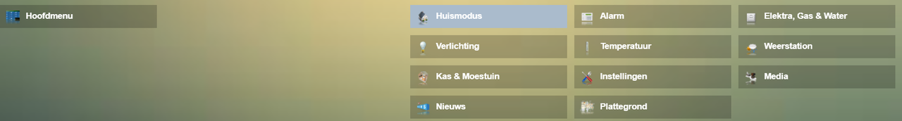

Hai Rob,
Nice work, I like Dashticz very much.
But I have way to many 'items' for 1 dashboard, so by creating more dashboards (screens) I'll keep swiping, so In my opinion there was only one thing missing, a mainmenu, I can now jump to the desired screen by a click/touch.
So with a little change in main.js I was able to create a menu with buttons, once clicked/touched will slide to the desired screen.
Maybe another option for Dashticz, but I like to see it in an ordered fashion, something in Config.js saying var Menu{} etc..

Any idea what I am doing wrong?
Jan
Lokonli
Posts: 2291
Post by Lokonli »
The button images are relative to the img/ folder.
So instead of:
image: 'img/hoofdmenu_mirror.png'
use
image: 'hoofdmenu_mirror.png'
And I think the first screen is slide:1
Further, it seems 'bt_Hoofdmenu' is not defined yet.

Post by JuanUil »
got the pictures in now but I can't get the format right.
