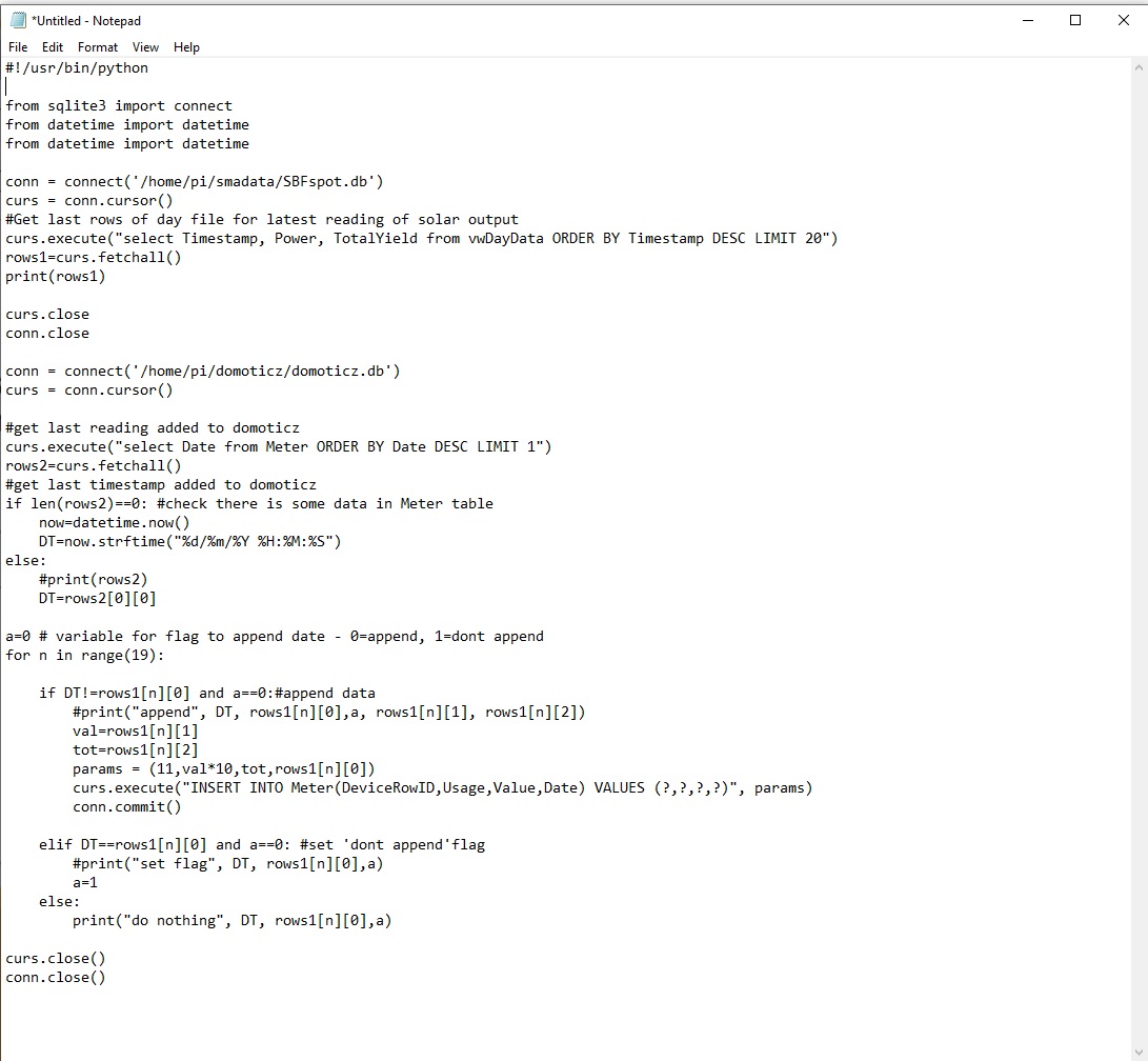

A great!
Was already screenshotting my code

#!/usr/bin/python
from sqlite3 import connect
from datetime import datetime
conn = connect('/home/pi/smadata/SBFspot.db')
curs = conn.cursor()
#Get last rows of day file for latest reading of solar output
curs.execute("select Timestamp, Power, TotalYield from vwDayData ORDER BY Timestamp DESC LIMIT 20")
rows1=curs.fetchall()
print(rows1)
curs.close
conn.close
conn = connect('/home/pi/domoticz/domoticz.db')
#get last reading added to domoticz
curs.execute("select Date from Meter ORDER BY Date DESC LIMIT 1")
rows2=curs.fetchall()
#get last timestamp added to domoticz
if len(rows2)==0: #check there is some data in Meter table
now=datetime.now()
DT=now.strftime("%d/%m/%Y %H:%M:%S")
else:
#print(rows2)
DT=rows2[0][0]
a=0 # variable for flag to append date - 0=append, 1=dont append
for n in range(19):
if DT!=rows1[n][0] and a==0:#append data
#print("append", DT, rows1[n][0],a, rows1[n][1], rows1[n][2])
val=rows1[n][1]
tot=rows1[n][2]
params = (11,val*10,tot,rows1[n][0])
curs.execute("INSERT INTO Meter(DeviceRowID,Usage,Value,Date) VALUES (?,?,?,?)", params)
conn.commit()
elif DT==rows1[n][0] and a==0: #set 'dont append'flag
#print("set flag", DT, rows1[n][0],a)
a=1
else:
print("do nothing", DT, rows1[n][0],a)
curs.close()
conn.close()

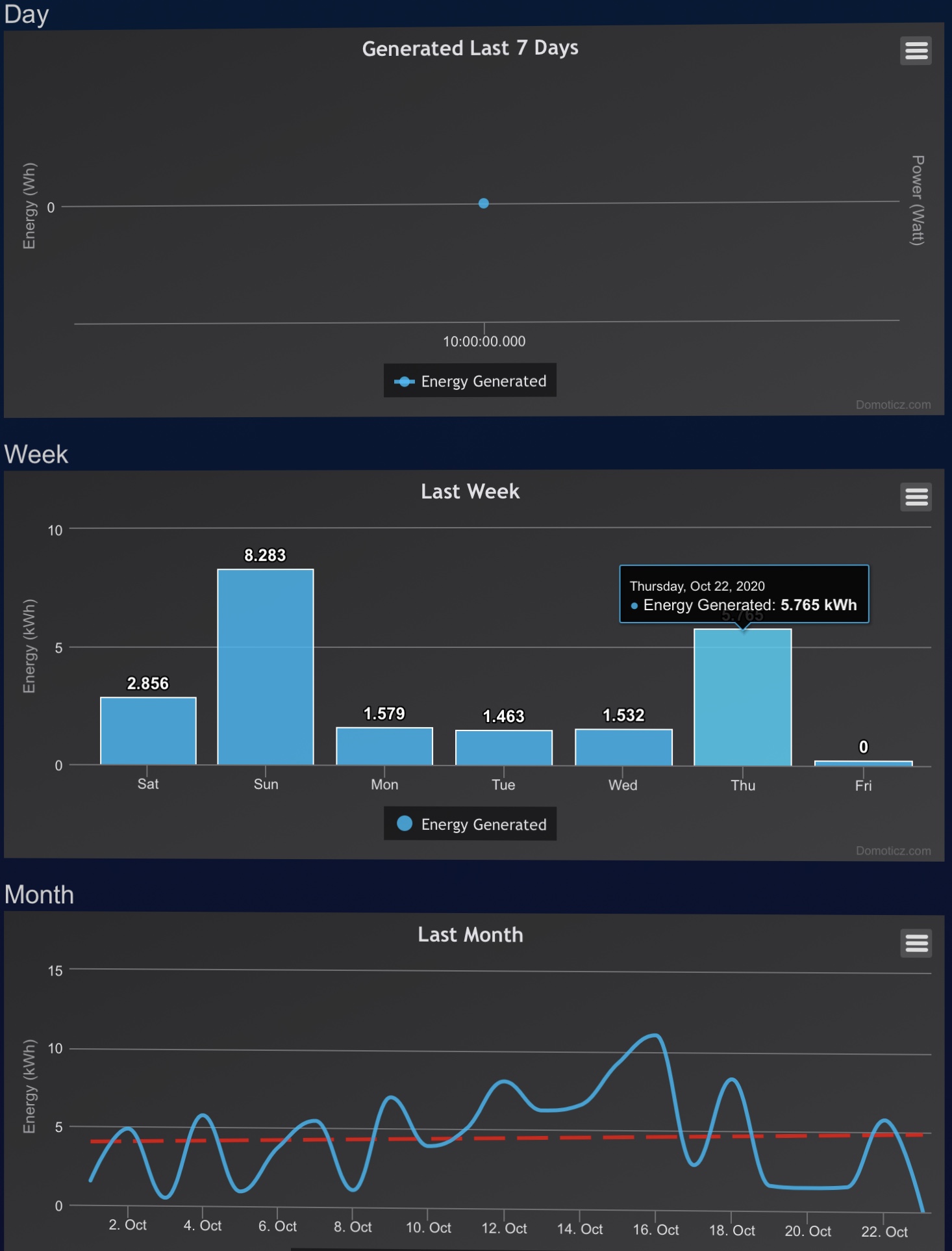

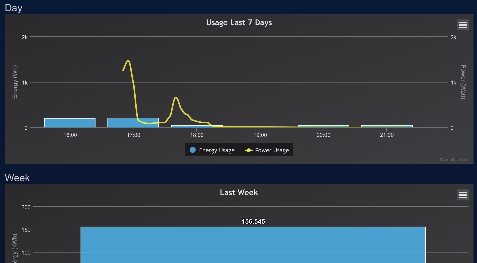

Very interesting! It works for the day overview but Friday shows total of the eTotal and not the day total.
And very surprisingly; SBFspot is now also working a bit.. not the daily but weekly and monthly is showing the right information. Don’t understand that the python script is doing the exact opposite.

Really not sure what’s happening.. the python script is now updating based on the current new numbers. It now also shows Saturday so I guess it was just the startup in that part of the script.
The ‘original’ is not showing current and still doesnt have the numbers from Friday. Tried to disable/enable but not updating anymore.

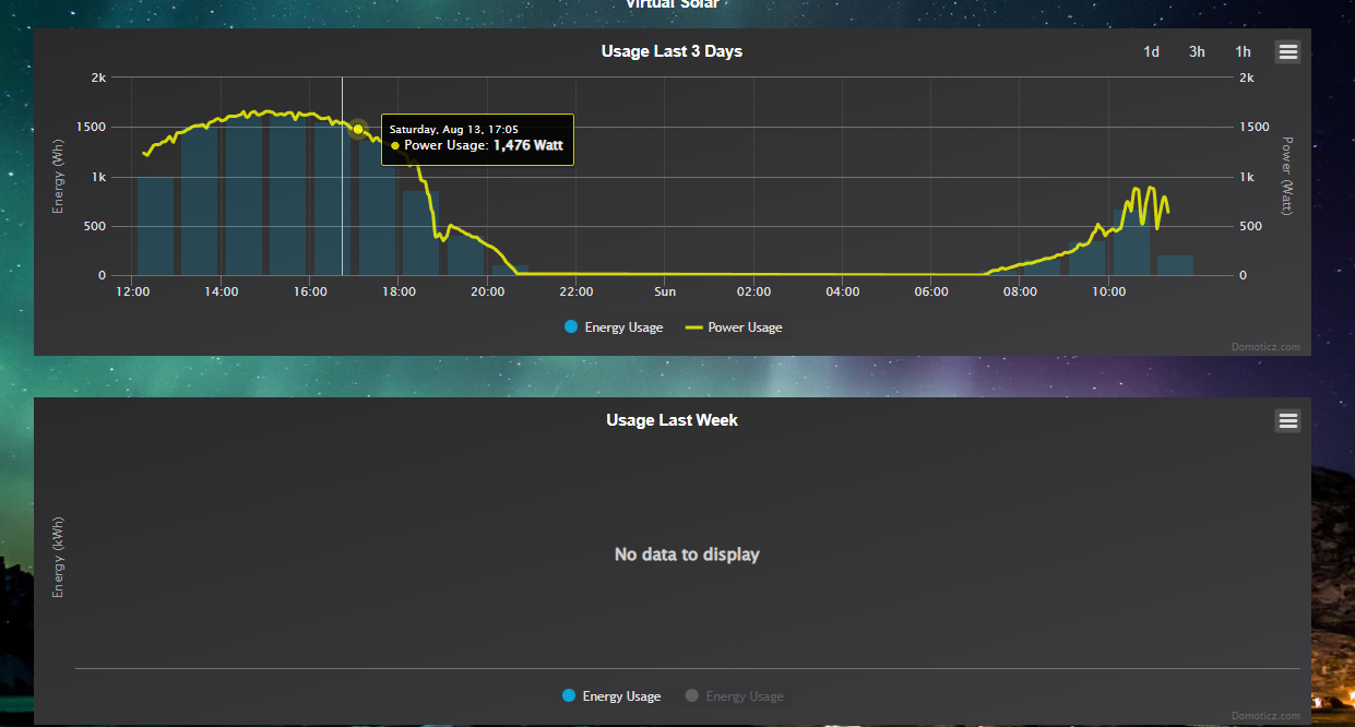

bontwoody wrote: Friday 22 November 2019 18:04 Virtualdevice.png
OK, so I havent been able to get the inbuilt import function to work properly but I have managed to use a virtual sensor and a python script to do what is required. There are a couple of glitches with the data in the image but Im very close. Im still fiddling with it to get the best results but Im happy to share how I did it with you if you want. Basically I an querying the SBFspot database directly and then inserting the values into the Domoticz database through the python code which is run every 5 minutes via crontab.
I just tested your script and it works :)
I used a copy of the Domoticz DB to do these tests !
I created one Device - Virtual Sensor(497) - Electric (Instant +counter ) => 243 General / 29 kWh Electric (Instant+Counter) voir ici : https://www.domoticz.com/wiki/Developin ... hon_plugin

But the result is not what I expected:
I have negative data!! :(
An idea ?
