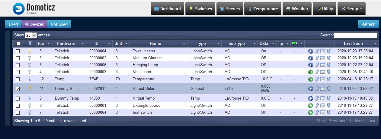

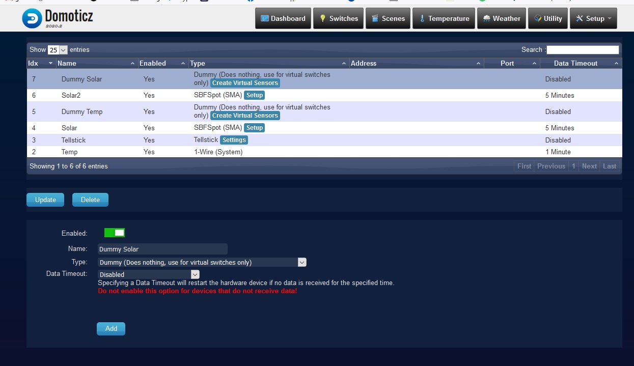

Mithrandir
Posts: 11
Joined: Thursday 22 October 2020 18:20
Re: No data from sbfspot to Domoticz
Post by Mithrandir »
sorry, that was not clear from my post. I know crontab but I am not sure how to add this to domoticz as virtual sensor.
I found the dummy, but still not sure how to get the results in my dashboard.
Post by bontwoody »
Right. Its been a long time since I did that and cant remember exactly. Ive had a play and first you go to setup-hardware and create a new hardware device. I think the type was important. Ill have a look in the actual Domotitcz database table and see what the settings are and get back to you.

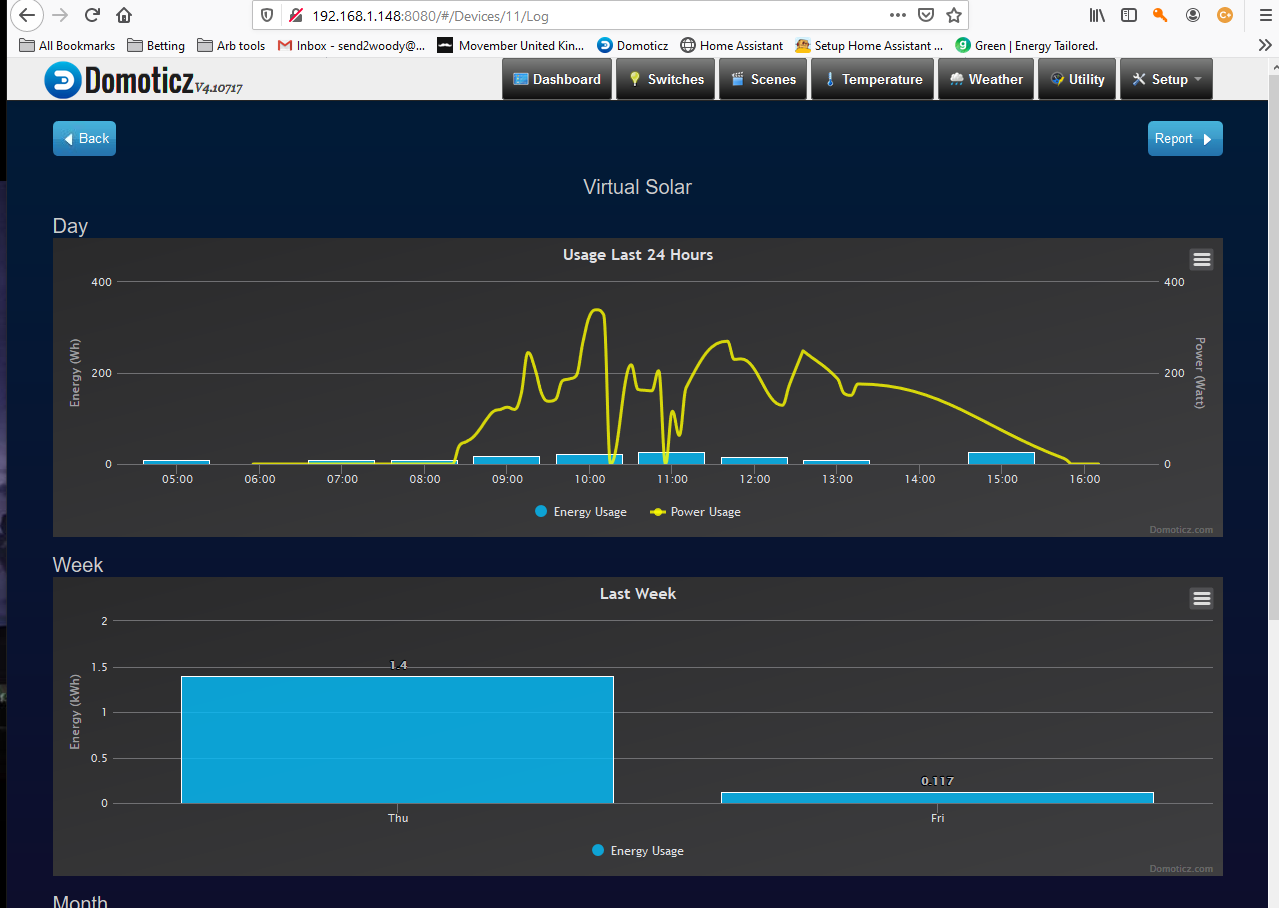

bontwoody
Posts: 16
Joined: Wednesday 29 October 2014 18:24
Domoticz version: 4.10717
Location: Wales
Post by bontwoody »
Right. I think I see what I did. Its easier if you can directly read the domotictz database. I use DB Browser for SQLite for that. To get the right display units, the device I created had a Hardware ID of 7, Type 243 and Subtype 29. These are shown in the DeviceStatus Table of the domoticz database. When you create a vitual sensor using the dashboard its details are stored there. You can even alter them directly in the table. The virtual device I created had an ID of 11 and its this value I used in my python script when inserting the solar readings into Meter table in the Domoticz db. The part of the python script that does this is:

Just to prove its worth the effort :-)

would it be possible to check the name of the hardware in your domoticz setup/hardware? my domoticz is on a RPi zero, so no graphical interface for DB browser available. and within sqlite3 commandline it's a bit difficult to add it like this.
So it would be really helpful if you could check in hardware for the name and within devices for the right virtual sensor. The rest is pretty clear I guess.
thanks!

Im not sure this is going to help but ill screenshot what I have. If you need anything else feel free to ask
