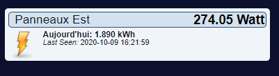

Other issue that I have.
The sensor indicate
1.890kWh
2020-10-09 16_22_12-Window.png (6.29 KiB) Viewed 4358 times
But in LUA I get 7688kWh, strange!
LUA: 274.05;7688
